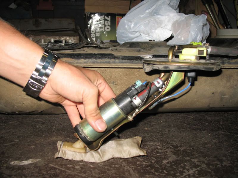

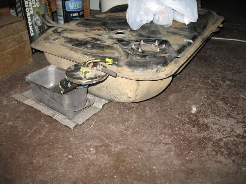

    Has anybody else investigated the CIvic pump idea further?
    Quote Originally Posted by worldwalker
    heres a couple of shots of the civic pump and pot against the 28 tank
    ([][][]II--LT--II[][][])

    I reckon MWP's solution is still the best. The intank idea is nice, but i'd probably only trust it as a prime pump for a car that sees a lot of track time. Just IMHO

    Agreed... There's no way I'm running my car without a surge tank for what I plan to do with it, but a nice simple idea maybe useful for others...

    Intank surge tank, but it requires a lot of tank mods (might even do something like that for the 28 though, and will be doing a full custom tank for the 23)
