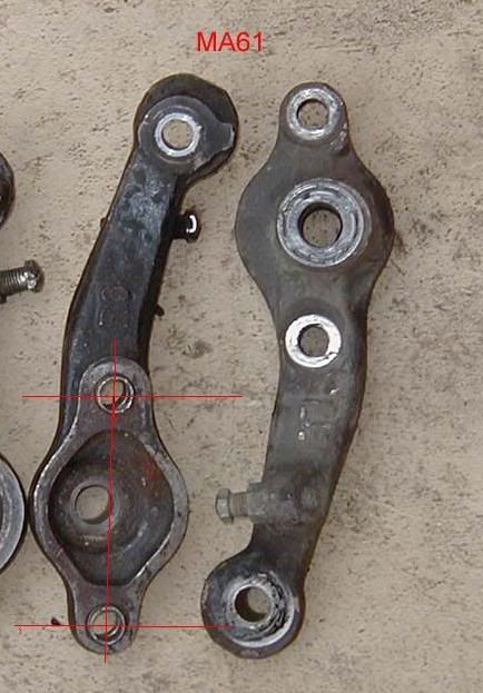

    Hey, just a really quick question here as i wont be able to check back untill thursday but does anyone know the strut bolt spacing on the bottom of the strut where it bolts into the steering arm/knuckle?
    Here's a picture of what i mean.
    Ignore the MA61 heading on the pic
    Sam

    It is 85mm, centre hole to centre hole. I designed my rcas recently so ive got the drawings lying around
