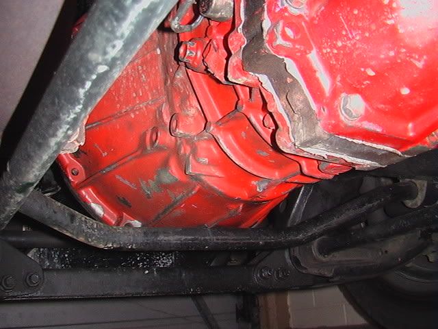

    Shamelessly ripped from Cruz's webspace

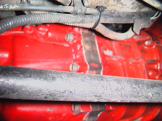

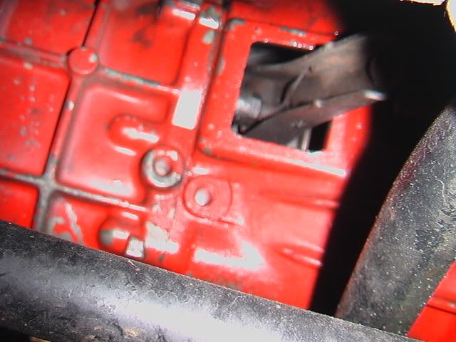

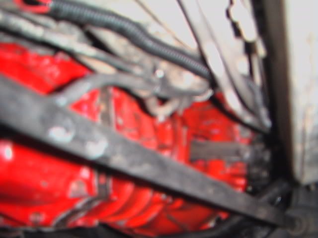

    lol, i will be upgrading brakes as such as well. it will be towing bikes, and going to the drags occasionally.
    ive got the bikes for corners. im not too concerned about handling as long as its safe.
    here are some pics of the gbox. they arent the best but sum1 might be able to identify it for me.

    That would be the W58. Has a push clutch and not as big as an R154.

    http://www.supraforums.com.au/forum/...ad.php?t=20823
    For picture comparisons.
