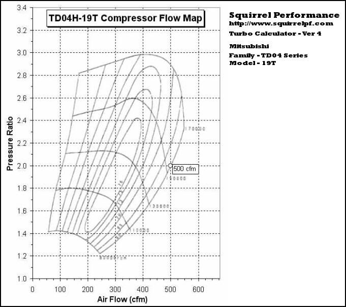

    also x2! the TD04 doesnt like boosting much past 12psi. It will do it of course, but it becomes a case of diminishing returns very quickly
    Mine would boost to 1 bar reliably anything up to 5,000rpm, after that it would taper off a little but rarely below 0.8 until close to redline, unless I was getting soak.
    Not that I don't agree with you, we're talking different engines and tuning here, and turbo setups vary enough as it is even on the same engine.
    We should probably nail down which TD04 / T25's we are talking about since there are a few versions and they perform differently.
    The TD04's I have are TD04H-13T's from the 2005 2.5L Forester (Part# - 49377-04502, same as WRX of that era according to the NAISOC forums).
    From the couple of looks at the compressor map and a run through the motorgeek "turbo" calculator (to get a ball park flow figure), the turbo should be able to run 18psi (361CFM @ 7500RPM) and still be in a relatively good region on the map (73% VS 76% peak). Running past that seems to be where it really dies off. I really dread to think of all the 2L/2.5L WRX/Foresters running them at 18psi >.>
    Side note: Punch in all the 4AGE @ 18psi details into the motorgeek calculator then plot it onto the GT25R (GT2560R) and damn does that look bad compared to the TD04H-13T :O

    My experiences are with early 2000s WRX turbos. Not sure how they compare to the one you have chosen knightrous. Another thing to consider is the accuracy of those CFM figures. When I was doing turbo sizing I found all the engine calculators wouldnt give realistic figures unless I entered some retarded BSFC/VE figures. I was given a guide of roughly 10lb/min for every 100HP by boxhe4d and that seemed to line up much more accurately with real world figures.
    Using the 10LB/min for 100hp numbers, at 18psi the engine should be capable of flowing 449CFM (for roughly 180rwkw with a 25% drivetrain loss assumption) which puts it well outside the choke line on that turbo. *disclaimer* i just calculated this all very quickly without checking and there may be some errors in there, dont hurt me if i did *
    Also a garrett 2560 is a bad choice all round, they are a very old design turbo
    I was mostly using the calculator to generate the flow figure (I'm far too lazy to find the formula and calculate it repeatedly), not as a "You get HP X from Y Turbuleh" . For your figure of 180KW, it's definately way in the choking zone of the TD04H-13T. IIRC, 150KW only requires ~360CFM (close to 18psi @ 7500rpm) which is within the safe zones on the map.

    Yeah that sounds about right. IIRC finney was making somewhere around 140kw on 1 bar and 160kw on 18psi. diminishing returns
