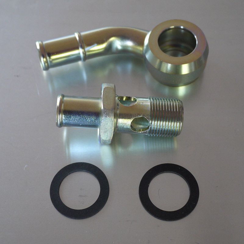

    could it be from the water outlet fittings on the back of the head as they do corrode? it could leak there and run down?

    Sam_Q, Yeah my cooling system was VERY corroded when I first got the car. When I finally pulled my thermostat, oh good lord, lol. And yeah I'm thinking it may be somewhere back there.

    The reason that I know about that fitting is because by request I was asked to get all the bits in along with other 7m gear, now I sell a kit that's as follows:
    $35 for the lot, genuine Toyota for the lot.
