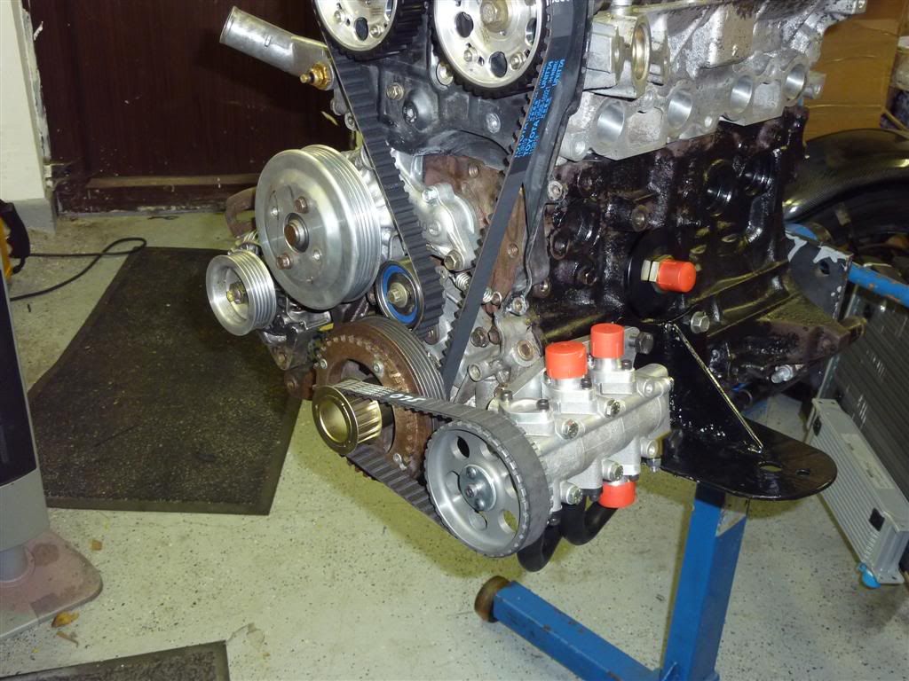

I'm currently working on an external mounted pump (single stage wet sumped) here's what I did :
So I removed the 2 stud for the oil pickup tube and drive/driven gear + back cover of the pump. The pressure release valve is also removed since I'm using a pressure release in the new pump. If you are using a sandwish plate to feed the engine, you will need to get the oil pass behind it blocked (welded or plugged) and then you don't need to worry about plugging the oil pump like I did. Reason I didn't want to do that was because of this :
Water heat exchanger as oil cooler in place of the stock unit.
Wrong, it's in the pass that goes to the head, between main crank bearing #1 and #2 so after the oil filter
