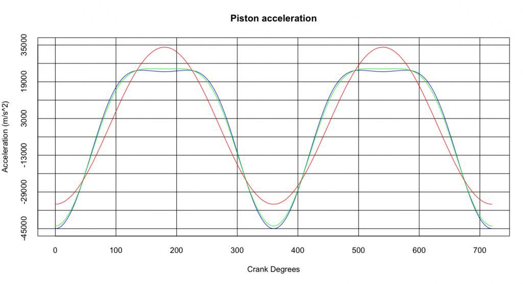

    I think I can just paste this here before going any further. It's directly taken from my build thread when someone ask about the theory behin this idea

    And to leave it there, here's a couple graphs I made :
    First is the difference between stock 4A, tom-age and the same engine with 77mm stroke but a 10m long rod (do not attempt, it's just to ilustrate an the point of what happens when you increase rod length. Notice the "y" axis on the acceleration graph
    Red = 10m long rod
    Blue = 4A
    Green = Tom-AGE
    Here is the same graphs with 7A, 4A and tom-age
    Red = 7A
    Blue = 4A
    Green = Tom-AGE
    End of lesson... but I won't go too far away if anyone has questions
