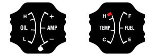

    Before I found an original set, I was going to make my own. I used the Temp/Fuel gauge as a guide and created sticker faces to use:
    RA28 GT Gauges.pdf
    Take this file to a signwriter (or maybe use VistaPrint.com ?), or if they need another file type I can provide whatever they need.
    They can even be inverted to white background / black text if you like.

    I actually found that file a few days ago and did some Photoshopping on it, I hope you don't mind. Nice job on scanning the gauges! Did you do the speedo and tachy too?

    I don't mind at all. That's why I share everything
    Until now I haven't had a need to do the speedo, tacho, or clock. I guess I should, eh? I had no idea they'd be useful for re-skinning the gauge faces!
