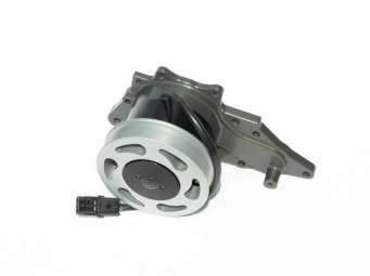

    Following with interest, particularly in the context of a 1JZ pwr'd Race / Circuit Car
    Miezere also do a 'bolt-on' pump for the 2JZ (should also fit the 1JZ)
    HERE - 35GPM rated
    Also been looking at the Stewart EWP's
    HERE - 55GPM rated

    Quote Originally Posted by allencr View Post
    How much heat do those electric motors put into the coolant, sorta pre-heating it from the radiator?
    At a glance, negligible to very little. Look at the size of the 12V supply in the picture above, that wouldn't be able to pull much power.
    And a quick look at the Davies Craig website gives maximum current (EWP80, a random pump I chose) at 7.5A. So max 100W. Entirely ignorable.
