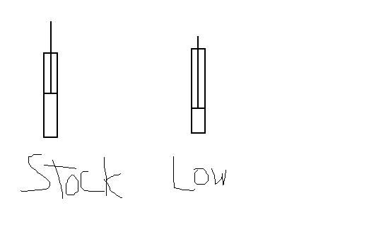

    Second, you misunderstood what I wrote or I'm not good at explaining stuff (<-usually the case) so I drew a pretty picture.
    Now, are the koni's you want standard length or shorter to suit lower cars. People say that running a shock near the end of it's stroke isn't good for it especially for koni's since the cool stuff doing the work on a twin-tube shock is at the bottom and you risk hitting this stuff with the piston if the car is too low.
    You will probably need to shorten the casing too. I noticed this the other day when I was screwing around on my car where when the strut with the wheel off was raised to ride height, the top of the damper casing was within 5mm of the bumpstop and I'm guessing the damper piston is near the end of it's stroke.
    Oh BTW, the picture I drew shows the damper piston sitting about middle of stroke when at standard height and near the bottom end of the stroke when lowered. Common practice on AE86's is to buy "short stroke" shocks. Essentially shocks that are shorter which will place the piston around the centre of the stroke when the car is lowered so you still have ~3 inches of travel in jounce in ~2" in rebound. The norm is(was?) to put ST185 AGX dampers into shortened strut casings.
