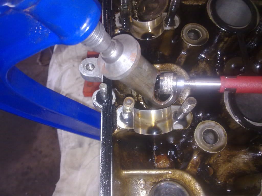

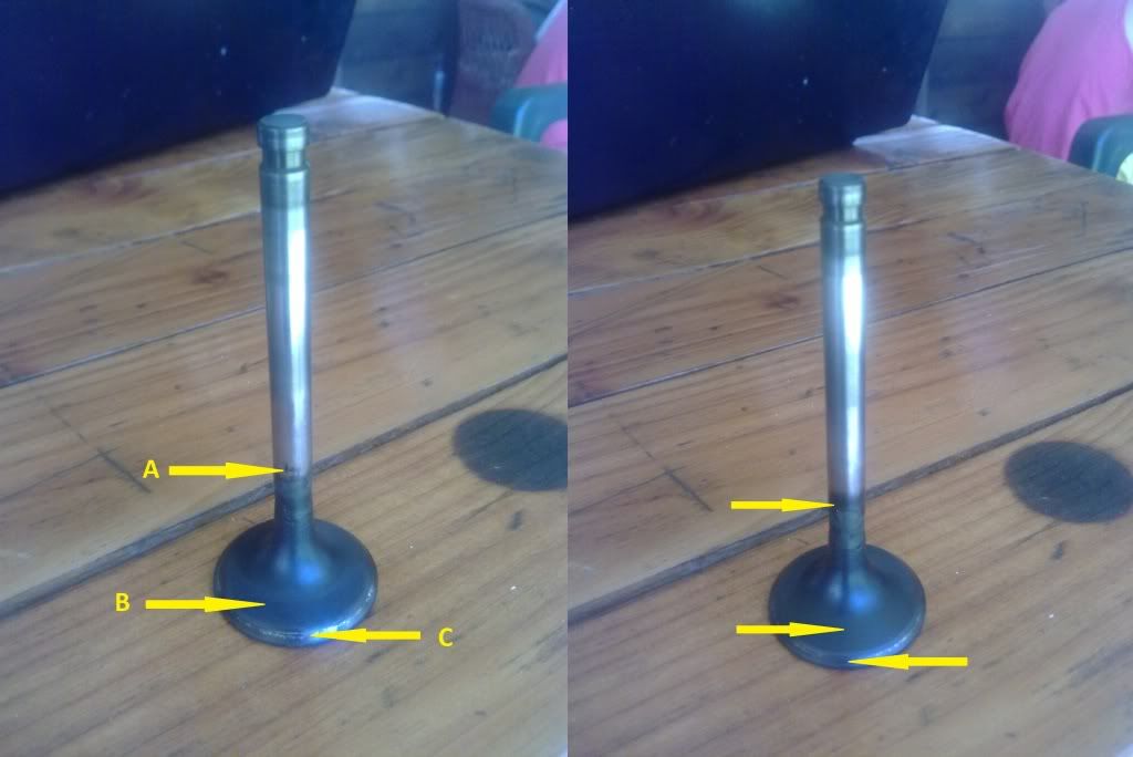

    SO I pulled the head off today, here's a photo of the valve from both sides:
    A: Shows wear marks on one side, carbon build up on the other side.
    B: Carbon build up on back of valve, other side is smooth with much less build up.
    C: You can see the bare metal from the valve seating on one side, while the other has carbon build up.
    A, B & C are all aligned with each other, so that spells bent valve even though there's no chance I could see it with my eyes.

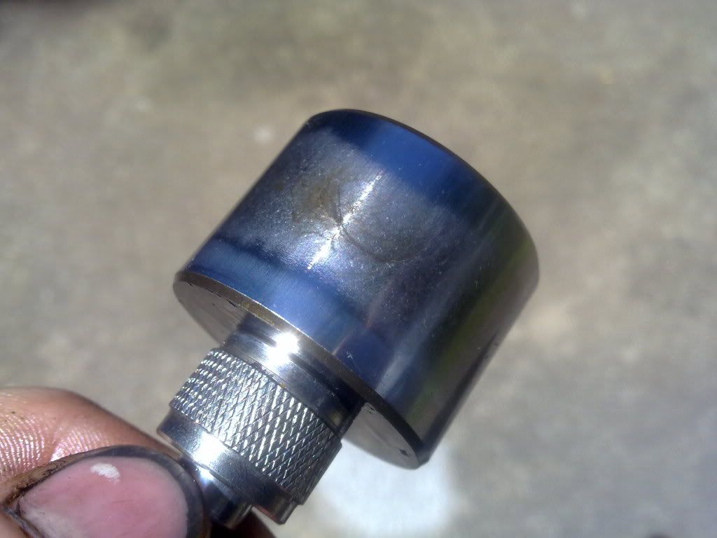

    Oh & here is the chemical stains on the lifter:
    Don't know what caused it, it's only that one spot on #2 exhaust lifter.
    Ghetto valve remover - G-clamp & a bit of water pipe:
    Magnet tool to catch the collets so they don't go walkiebouts
    Jan 2012
    Finland
    154
    Default Re: 3TG valve problem - help/advice needed
    Simply go with that valve to the machine shop and ask them to check it on grinder.If it's only a small amount wiggly and trues by light cut use it.But never try to knock them straight!! Those OEM exhausts are two piece items and WILL snap to two it trying to bend them back.
    Intakes and most aftermarket SS exhausts are one piece and there moderate straightening is acceptable.And no,if they were available every parts store cheap they should not be straightened but get new ones.
    And one thing with those magnets;they are extremely handy picking up small missing parts but snapping a strong magnet on hardened steel part..
    Check that if you are able to pick-up small steel parts with those buckets.Not a good thing that parts collect all the wear particles to them.
