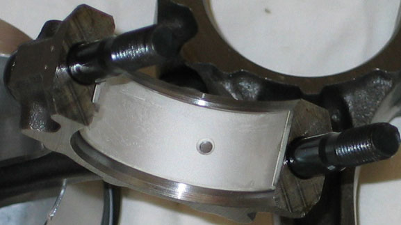

    All T series engines have the same rod length except the "T" (The 1.4l)
    The pin and crank bearing sizes are all the same.
    The Oil passage location varies between the engines so make sure you get the right bearings !!! Here is a pic of a 3T-GTE rod as fitted with a 2T bearing.
    The 3T-GTE rods are allegedly stronger and forged.
    I personally have swung the stock 2TG rods and stock 3T-GTE rods to 8500rpm on a very regular occasion.
    Ryan with the infamous white & Red 10sec 3T-GTE powered TA22 in the US campaigned on stock 3T-GTE rods until he bent one.
