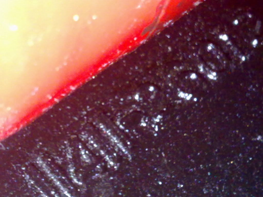

    Well everybody I've done 150km on the new motor without any hitches, so I guess the grinding was enough. Haven't taken it over 5g yet though. I guess I took about 3mm of meat off, minimal possible because I was worried about reaching the coolant side.
    173
    Default Re: Grinding a 2TG block to fit 3T crank
    good stuff, mate! hey, forgot to ask before - what's the casting number of the engine block itself? I think there is a number cast into the block near the starter motor - want to check if mine is the same casting or not. I'd take that weber off your hands if I had a spare smiley bar - let me know if you come up with a $ amount for it including getting it to brissy if you still want to offload it.

    Yes I remember seeing some extra numbers there plus a little tag screwed onto the block with numbers, didn't take note of what they were though. This is the best look I can get at them without pulling the starter:
    If you want that weber, $110 & I'll post it to you with everything needed minus a new airfilter, but they're less than 20 bucks from auto stores.

    Looks like 11411-36013 to me
