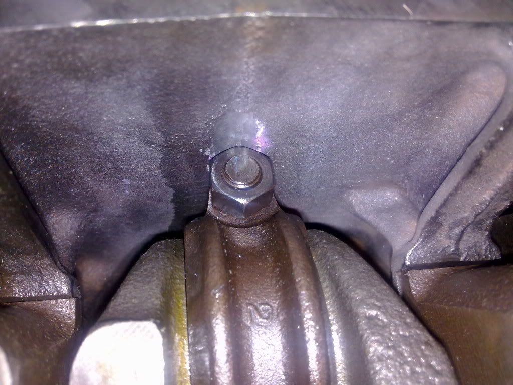

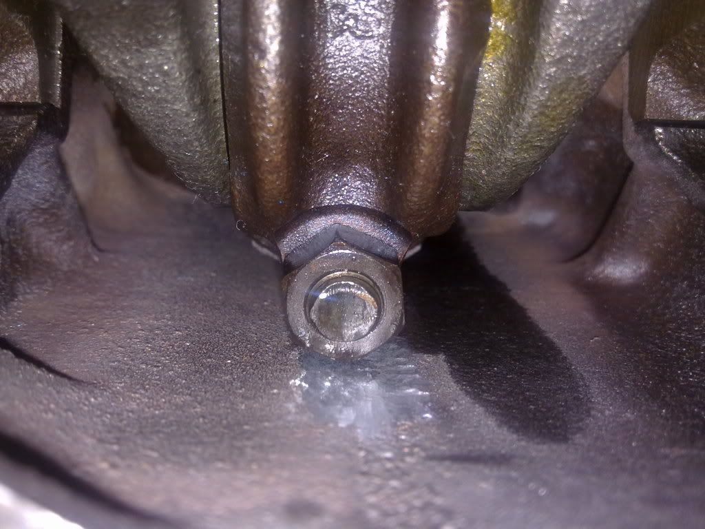

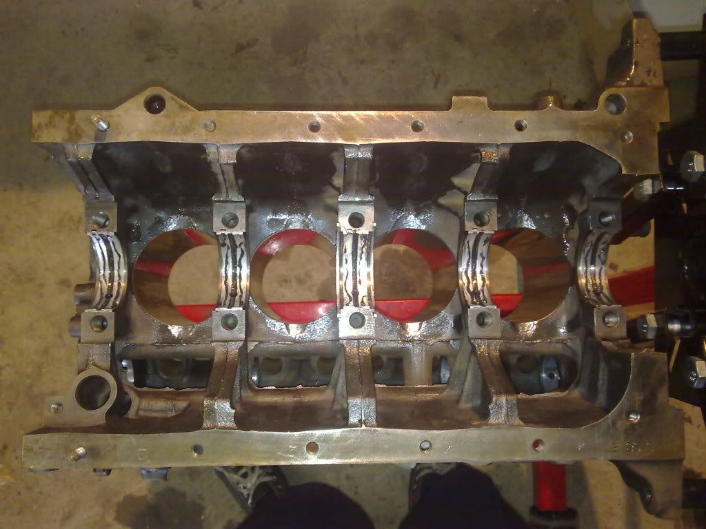

I'm in the process of building up a 3TG hybrid motor - 88222 2TG with a 3T crank & pistons. Since I didn't have room I never kept the 3T block, so I have to grind some of the 2TG block to suit the longer throw of the 3T crank. This is where the conrod bolt & nut interfere with the 2T block:
My question is how much clearance is needed to make sure Mr. Steven Conrod never meets Mr. Ken Block? My trial fitment at the moment turns over freely. The amount of clearance is this much: with a thick film of 20W-50 on the area, the top of the conrod bolt just pulls on this film as the crank is rotated to near TDC. Don't know how much this is but it gives you a good idea of the fit. I know with the heat and immense forces of running the motor things stretch a little, so I'm a little dubious about the clearance, but at the same time I'd rather not have to disassemble everything, block up all galleries & holes, grind more & thoroughly wash the block to remove filings etc.. blah blah if I don't have to.
Pics of trial fitment:

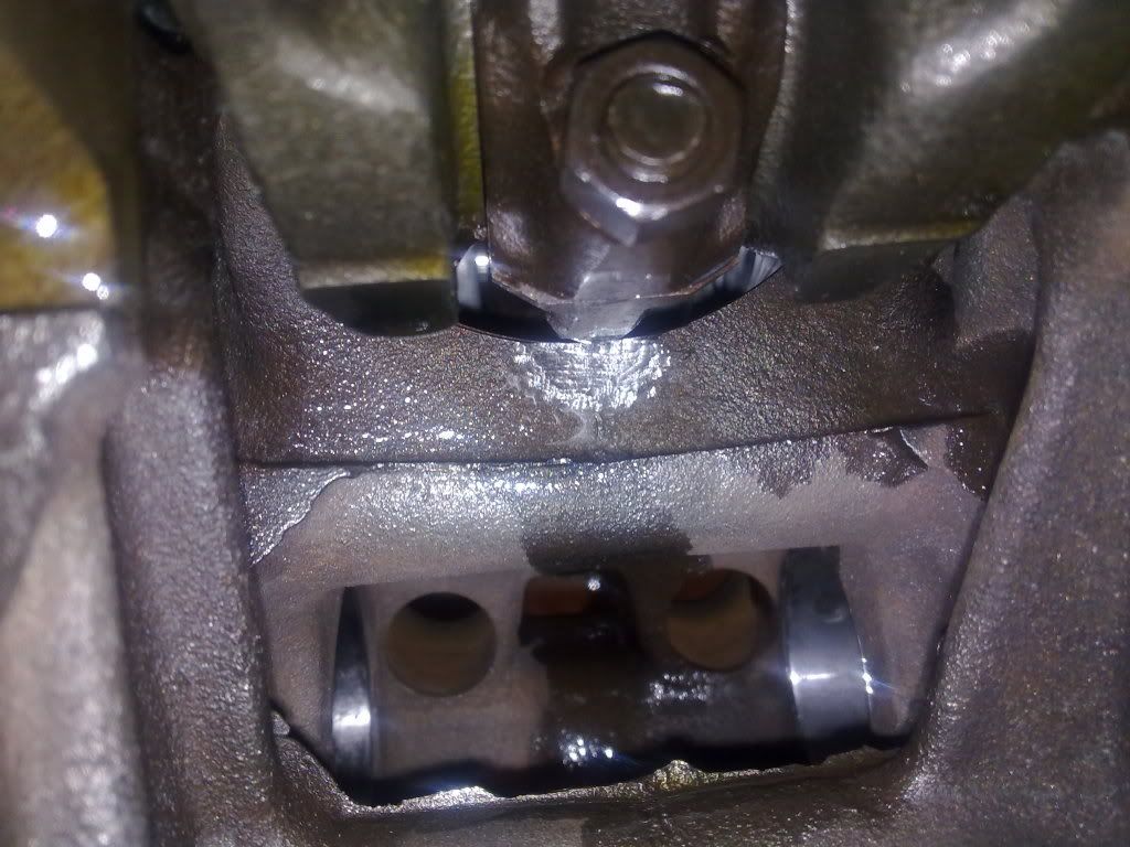

In this one above you might be able to just see the film of oil grabbing the conrod bolt.

just grind enough away and leave enough room say 2mm around near rod bolt and back of bore where it gets close
i see what you did there.
i think 2-3mm is a good rule of thumb, with thermal expansion alone that would touch, without taking into account stretching/bending of the crank etc. there looks to be enough meat where you are working to play it safe rather than sorry, id say keep grinding (unless there is some particular reason to not take much out)
have you checked clearance to oil pump, pickup, aux shafts etc? im not a T motor man by any stretch but i have come across these issues when playing with different stroke M motors.

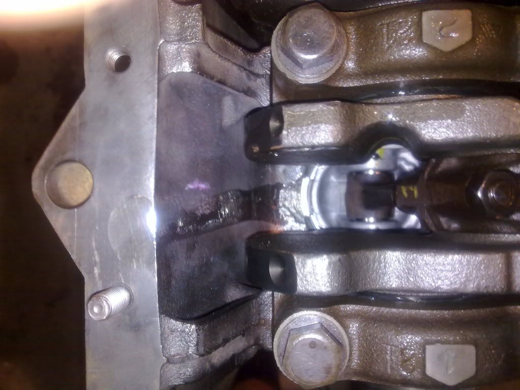

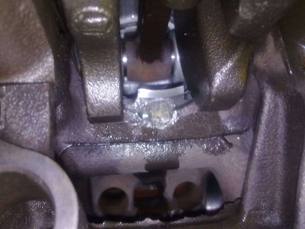

Hey Darren, here is what it looked like finally:
Hard to say how much clearance is there. Visually it looks like ~2mm. In my logic that should be enough clearance as ~2mm of stretch would mean the pistons would be hitting the combustion chamber anyway. If the motor blows up then I guess there isn't enough clearance![]()

Oh & Vanman after looking at the picture closely I think that is the grinding before my first trial fitment of the crank & pistons. It did turn over freely with that much taken off, but I wasn't happy with the clearance so I grinded more. That pic gives you an idea of the minimal grinding needed, but I don't have a pic of the final pre-assembly.
No worries, jess... Pics looked way too close for my liking anyway, will probably grind further myself. I have a stock 2T, 3T and 13T at my disposal, so will measure standard clearance as a guide. Hope yours works well though

i have keep minimum 1mm tolerance, it have been enough at my engines... sometimes that block is very thin at nearby cylinders, like 4mm grinding and you got hole to the coolant side.
never got problems...

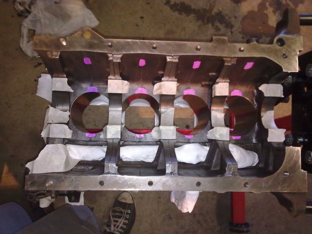

The grinding isn't that hard with a die grinder & compressor with a rounded bur using silicon spray as lube. The larger diameter bur the better as I found out after buying a small one. Took me a good day of masking, grinding, cleaning, assembling, disassmbling, masking... you get the idea, lol..
