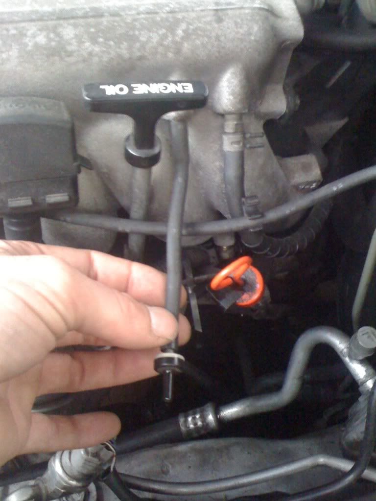

    this is the one that i have not got connected but it runs better with that 1 on the map sensor. but theres 1 the other side that i have now connected to the map sensor.

    i suspect that one is for the charcol canister... should be sitting up on the firewall... big black thing with hose barbs on the top of it...
    can you take a photo of the other side of the intake manifold?

    thankyou do i t peace into the cannister pipeing as i have the 1 from near the diagnosic box to the cannister.

    Quote Originally Posted by midnight_purple_GA70 View Post
    In a JZZ30 it should go to the VSV that controls the "heater tap"

    thanks wilbo
    do i just block the end of it.
    the 1 in this pick i have put to the map sensor.

    Yes, block the hose that normally goes to the heater tap in JZZ30.
