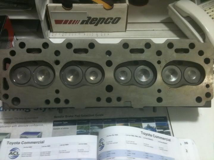

    Hey guys had a mechanic come through work and doesnt know what this head is off but needs a headgasket for it? Does anyone recognize this head at all? Cheers

    Default Re: Whats this head off?
    is there a number in the casting somewhere? A pic of the manifold and valve sides would work/help as well.
    it would be 5r from a 42-3FG20 fork lift truck
    Got this pic from a workmate. Im currently on holidays in QLD so cant really get any more pics.
    Its a 5r head.
    Just checked the pic against a pic of a 5r headgasket and confirmed. Thanks CelicaSupra7m.
