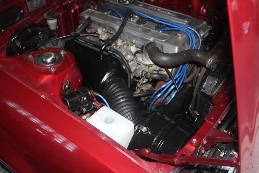

    Stradlater, we have got hold of a perfect set of bonnet hinges andare looking at making up a jig to straighten bent ones then weld in a reinforcing plate like we have done my bonnet hinges in my 23. I will let you know when we get it made up if your interested.
    Bracing we have done to mine is shown in the bellow photo, i'll try and get some better pics:
