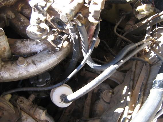

    Okay still no luck, I can't manage to put the lever in front of the lobe, its a bitch. Is there a easier way to put it on? Anyway thats my problem I think, heres a pic of my fuel setup.
    Thanks guys,
    Brad

    Quote Originally Posted by Brad-KE35
    Hey guys,
    Thanks guys,
    Brad
    did u try what i said above ??

    Quite a few people have touched on what is probably the correct problem and that is that the pump has been installed incorrectly lever in behind cam lobe instead of front of cam lobe. Did I notice a air compressor in the photos? It that case yes a bitch of a job to put on. Start by putting the lever of the pump towards the top of the hole in the side of the block then applying pressure on the pump guide it onto the studs. Unfortunately you have to apply pressure with one hand and screw a nut on with the other. At this stage do not concern yourself with the washers. Get one side on and the other will follow. ONce you have a nut holding it you can put the other nut with the falt and lock washer on. IOt would certainly make it harder with a air compressor in the road.
    One thing that nobody seems to have picked up on is this. The pump may have been put on correctly but you will never pump any thing if there is a slight vacuum leak when the pump is stroking. You can blow air back through lines and hear it gurgling in the tank but it will not show up a vacuum leak. The earlier Crowns had a glass bowl filter on the inlet line. Once you change the filter you had to replace the seal for the glass bowl otherwise you had a lot of trouble to seal it. If you bought a genuine Toyota filter you got a new seal after market you did not. The idea then was to turn the seal over. Check for any leaks that may occur under a negative pressure in the supply line. Faulty hoses, cracked tube (it Is a paddock basher, isn't it?). If the pump is working and you say you have had this verified. Then the problem is either or or both of the above
