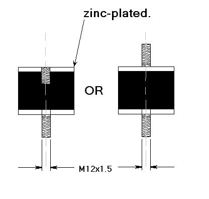

    Went to have a look at the Celsior in the exhaust shop today, and needless to say both engine mounts are broken, as expected. While the headers/rack/etc. are conveniently out of the way and the car is sitting in the air, it would be a great time to replace the mounts. Has anyone got suggestions of new/rebuilt/whateverelse replacement mounts that are bearably priced, and might just possibly even last a bit better than the original ones?

    how tall is the rubber part?
    we have rubber mounts at work, for industrial purposes(gearboxes, shakers, big 3 phase motors etc....) i also need mounts for my uz conversion and was gonna give these a try, but mine's custom whereas yours need to be a certain height, hence the question.

    the mounts i'm talkin about look like thissolid rubber)

    make some up. two part urethane will do the trick

    This is the kind of thing I was thinking of - got any specific advice on what to do/use?

    mackay rubber products, they have all sorts of mounts in stud and threaded designs. Repco etc should have them and blackwoods definately has them.
    http://www.mackayrubber.com.au/pdf/enginemount_web.pdf
    Link to engine mount catalogue /\

    that mackay catalogue has the rubber mounts i mentioned in it. if you want some of these, i'll see how much they cost(my price ) i think they're pretty cheap...
