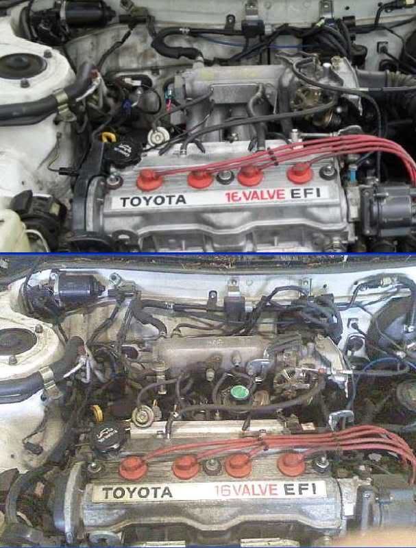

    I got the 1st oil change done today. Rechecked the timing and adjusted it a bit more as well. Grunt pulls HARD... very HARD. She pulls so hard that I've hit the rev cut a few times by accident. In fact I'd be willing to bet she'd dust a stock, and maybe even a few modded AE86s...... (I'll let that sink in a bit)
    Yes, she is that good right now. The only changes so far are the intake, the 1/2 point bump in compression, and the ported head, the cams are stock, the exhaust is stock still too. The header I bought from Ireland** can't be used until I re-make the downpipe. The All-Trac uses a curved downpipe to avoid interference with the E55(all-trac) gearbox, the downpipe that came with the header is straight - for fwd applications, NOT 4wd.
    Comparing the old engine(bottom of pic) to the new engine (top of pic) a few things besides a cleaned up cam cover can be seen.....
    1) note the EGR modulator, and the EGR valve are no longer in the valley between cam cover and intake plenum.
    2) if your eyes are really good, you'll see the absense of the 5th injector, and if they are superb you'll see the blocked 5th injector line
    3) again if your eyes are good you'll see the wiring splice required to fit the IAC - Toyota also changed its location - originally it too was in the intake valley, but they changed it to be on the end of the intake manifold
    4) yep... same wires, same cap and rotor, SAME spark plugs too
