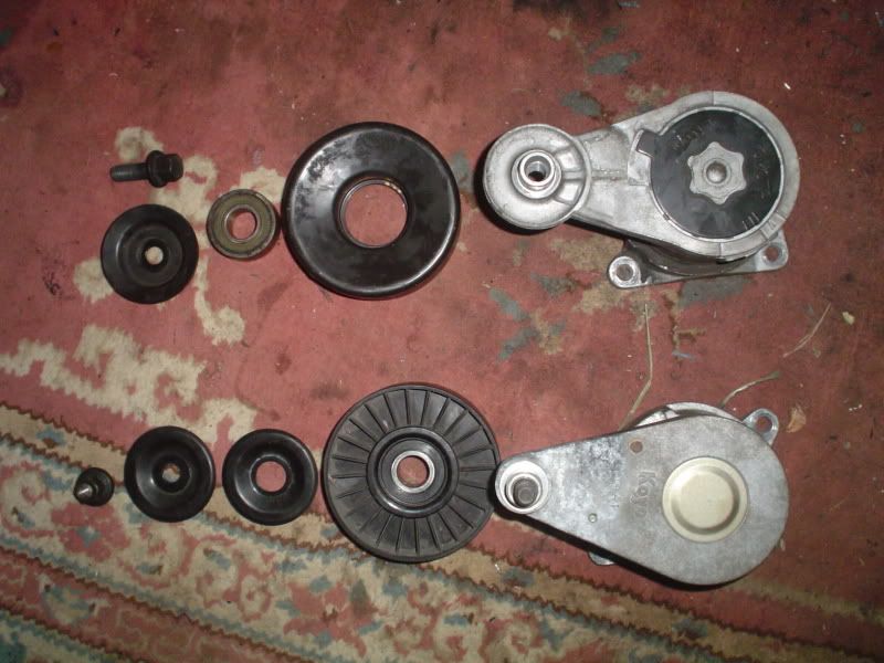

One thing to note is that only the early xJZ tensioner pulleys are steel, the later ones are plastic and can't (at least not easily) have the bearing replaced (It's secured in placed by 'stamping' the plastic)
The later plastic pulley does fix your observed design fault tho!
See pic

Yeah a proper stud with nut makes more sense....Toyota learn from their mistakes at least![]()
