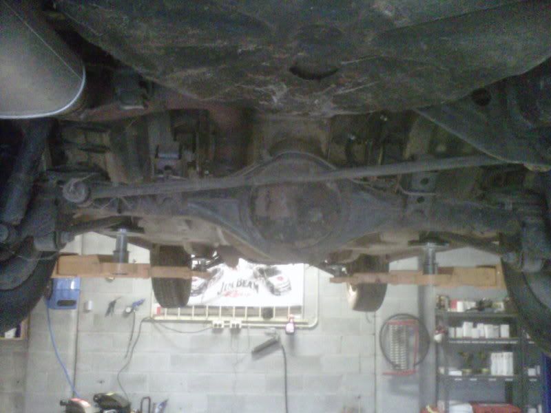

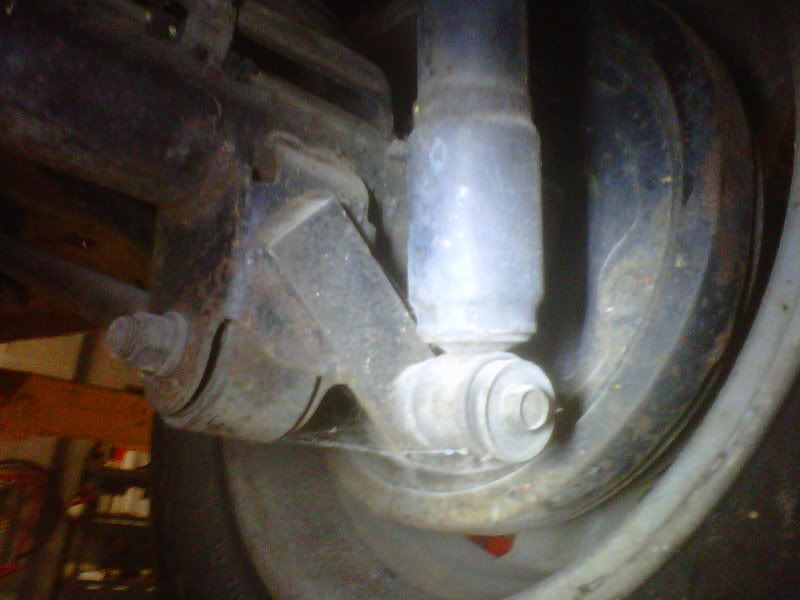

    Can anyone shed some light to what diff this is, i dont think it is the original, looks rather large and the shock mounts as picktured just look like a bit of 10mm flatbar weldeed on any ideas would be great thanks

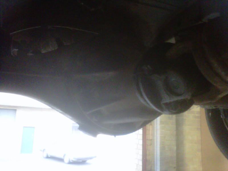

    It looks like a standard T series to me (though it's very hard to say much from those photos. Get some better ones, or just refrain from using highly lit backgrounds).
    Shock mounts look like that normally. Another point is the routing of the brake hardlines. It looks factory to me (bends out behind upper trailing arms mounts) and a converted diff would most likely route them in an "easier" fashion requiring fewer bends.

    Sorry bout the pics. Thanks Hen
