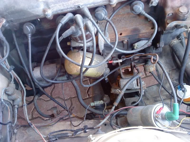

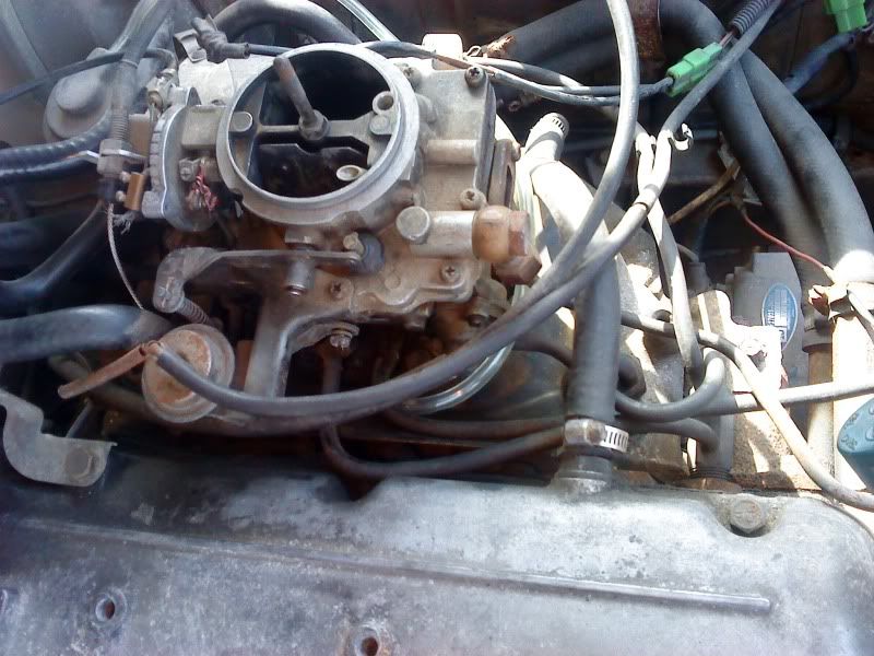

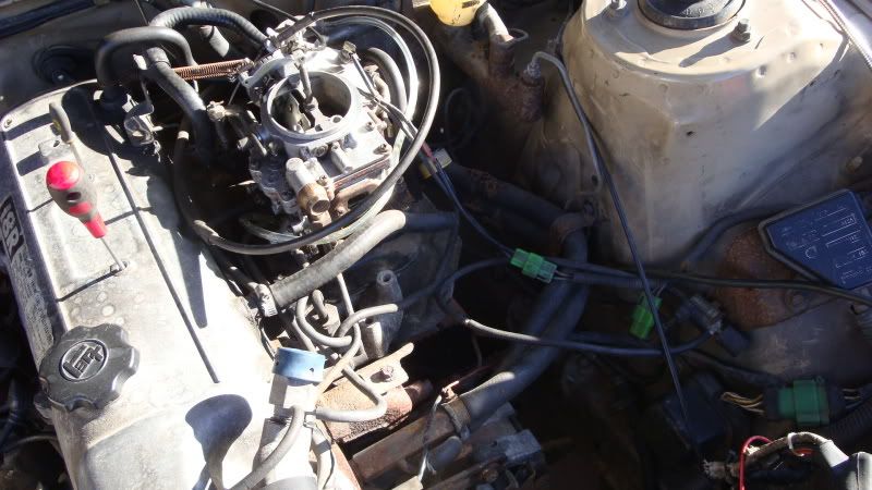

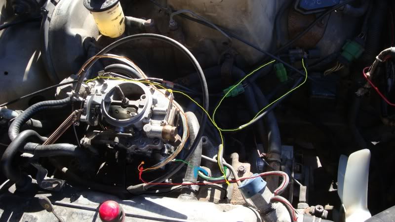

    may I present you a highly pornoed engine:
    This engine was transplanted into this Soarer by one of the previous owners (yes, I'm probably going to throw a 7mgte in there, but I just wanted to make a quick round in the village with this engine ).
    Half of the carb or parts relavant areprobably missing (I searched the 18R diagram thread etc - air pump, VCV's and stuff should probably be there?).
    Other half is probably broken and non-functional.
    The second butterfly isn't operated by anything basically (though I cannot understand the blown diagrams either, so maybe someone has some pictures that show how everything should be put together and function ?)
    I did the best I could with the vacuums, but maybe someone could enlighten me

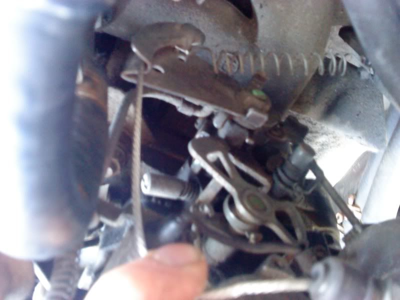

    (+what doesn the valve do that's on the next pic that has this spring attached (spring itself is for the "automatical" retraction of the manual choke)? The lever on it goes nowhere, the vacuum on it goes to the electronical VSV, but the other end on the VSV is open).
    Though once or twice I got it running quite normally at idle for some time til it died off, so that's why I'm asking for help!

    Default Re: 18R carb help needed badly
    Most of the diagrams youll be finding are for the 18R-C, not for the 18R.
    The 18R didnt have any pollution control stuff on it, so it was a much simpler (and more powerful) engine.
    There is a little glass window on the side of the carb.
    Clean it up so you can see through it. When the engine is running, you should be able to see the fuel level inside.
    It should sit at 1/2 way up the window.
    To high or too low means you have fuel pump or bowl float/valve problems.
    If thats ok, then play with the idle fuel needle setting.
    There are two small vac hoses that come out of the bottom of the carb. The idle needle adjusting screw is between those.

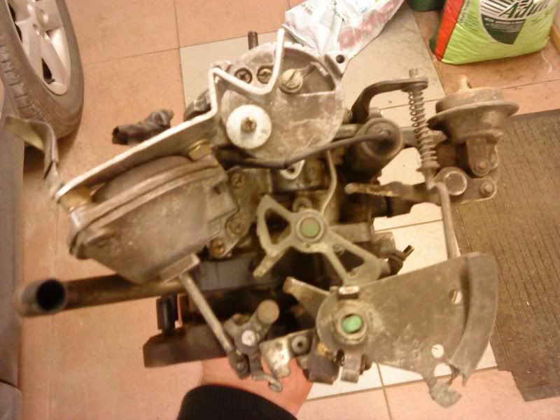

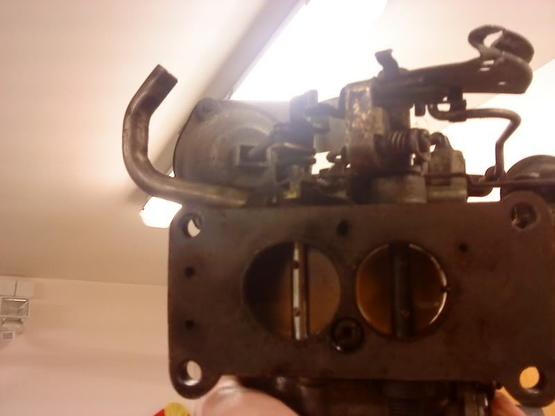

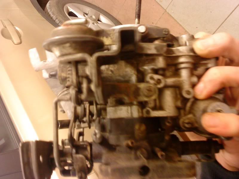

    Took the carb off, is this normal :
    Fuel
    Valve not closing fully (remember from my buddys suzuki carb that everything was closed? Or it had extra idle ports,hmm. Have to go through the green 18R repair manual )
    that's how mine looks:
    Gonna try to dismantle, clean and research it tomorrow. Extreme "adventure".

    Definately getting too much fuel. You only need 5psi fuel pressure. You need to take the top off the carby to set the float level. While you have the top off the carby take the float off and check the needle under it. The tip of the needle can wear so it doesnt seal properly when the float pushes on it to shut it off. Some needles are solid brass and can get an indentation worn into it. Other needles have a viton tip which is like rubber and they can tear so they have a piece missing or can have a flap that can cause it to leak sometimes but not always. A carby rebuild kit should have a new needle and seat in it. I can see you have a spring missing from one of your throttle linkages. the second barrel of you carby will not work if the spring is not connected. It is hooked through the round plastic thing on your throttle linkage normally and the other end goes up near your choke somewhere. It might be easier to get another carby because yours looks fairly rough and has a lot of bits missing. They are normally fitted with an automatic choke which has been converted to a manual choke on yours. The thing with the wire going into it is the idle fuel cut solenoid and needs to have power going to it so your engine will idle

    Just took it apart, was full of crap ofcourse One more cool tuning- of the main (?) jets (that have the bolts on the side of the carb to cover them) was tuned with a wire through the hole to not let through so much fuel. Cool
    otherwise other jets and needles sseem to be ok and not damaged.
    And that is not a 18R carb. As i have some of the emission stuff.... I took it apart too fast, thinking that the repair manual will help me afterwards and as I now see it just doesnät show half the things I have oeh...

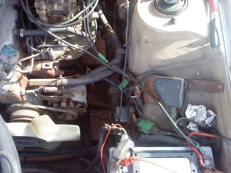

    I just noticed a problem with you vacuum hoses. There should be a hose from your vsv to the thing on the thermostat housing so you have vacuum advance to your distributor. It would be best to connect the hose from your carby directly to the vacuum advance can on your distributor. Where the hose normally goes to the thermostat housing is a thermal switching valve which restricts vacuum advance when your engine warms up. It is part of the emissions equipment and will make your engine sluggish and use more fuel so people normally bypass it. The vsv will stop vacuum advance totally when it is shut off at certain times. You really need the vacuum advance working when your engine is cold so try to get that working before you do any more to the carby.

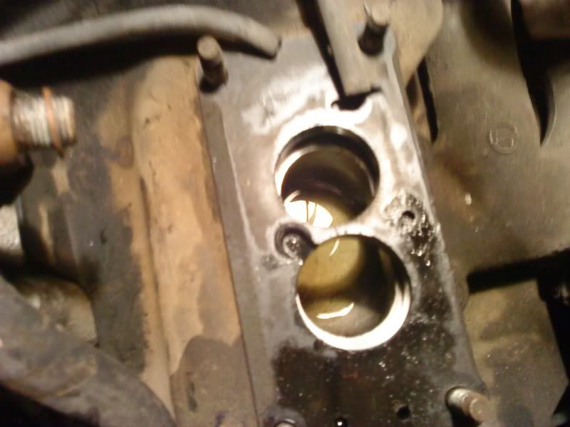

    I opened one of the throttle valves so I could see inside of the manifold - all I can see there is fuel Could it still "get" not enough fuel?

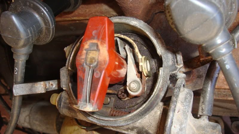

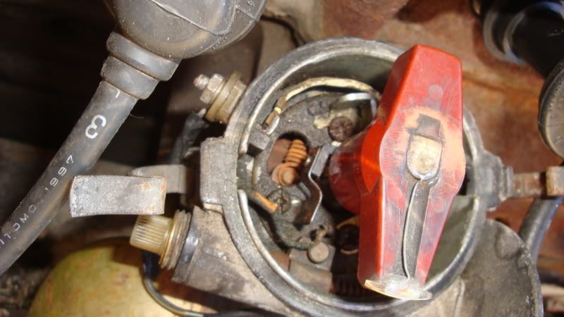

    But now, at the timing thing I stop understanding I'll take a picture, maybe you'll see something.

    Quote Originally Posted by Dazza View Post
    Good catch. That was how the engine originally came to me. Now I've connected it to the thermostat. Gotta rewire it to the carb then.

    The dizzy
    This is how it's setup now. Does it seem to be about right?
