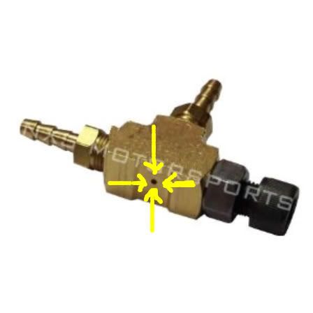

    http://www.dragtimes.com/parts/MBC-M...467649122.html
    This is the boost controller i`v got, it has 3 outlets, n im drawing blanks as to which way to do it RIGHT !!

    most mbc's have 2 outlets with a vent to atmo port.
    you're one has 3, allowing a choice of inside cabin installation. (great idea)
    the three connections being
    1-Pressure source from the turbo compressor outlet
    2-Connection to the wastegate actuator
    3-Connection to the intake-pipe, pre-turbo
    look for the arrow or using your mouth blow through one outlet and feel for air through one of the other outlets.
    the port that has the air flow-through goes to the actuator, then all you have to do is #3

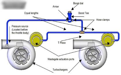

    I see what you`re saying but from the picture it seems we are blocking off 1 of the compressor outlets. is that a good idea ? In addition to your approach I found this approach as well without the blocking thing (in the attached pictures). I am not sure what the technicalities are of this....good or bad...
    Lastly what is number 3, as in how is it done ? where does the pipe go? The reason I am asking for 3 is because I was going to put a small filter on 3 to prevent any dust from going in but thats about it till I read what you wrote......any help ?

    Also when you say mine has a choice of inside cabin installation, im guessing other 2 port MBC`s dont have this ?? if so how ? (just some knowledge to make more sense in my head on the options or what to do). Cheer!!
    Jul 2008
    288
    Default Re: Increasing Boost on 1g-gte
    all typical 2 outlet mbc's have a port hole
    it is not filtered or needs to be, its exit only.
    running this mbc in your cabin will result in escaping exhaust fumes. (not good)
    your one has a port fitting enabling you to fit a hose, so fumes can be recycled back into the intake piping. (pre turbo)
    or alternatively you can install into the engine bay without any hose or filter, just leaving it as is.
    do not block it off...
    the first diagram is the same idea as the one i posted. (bocking off the rear turbo)
    the second one is a electronic boost controller setup (no good in your case)

    Wouldn`t Blocking off the rear turbo be putting a strain on the rear turbine, compressor housing ? Like the 2nd diagram for the electronic boost controller, I found similar knowledge on the net for a manual one, without blocking the rear one. i.e. t-pipe the 2 compressor and t-pipe the 2 actuators and both go in 1 and 2 ports of the boost controller and 3rd as u clarified can be pre turbo or left open........is there any advantage/disadvantage of blocking the rear one ??
    Don`t want to loose a turbo in the process, so just want some expertise knowledge......thanks for the valuable replies
