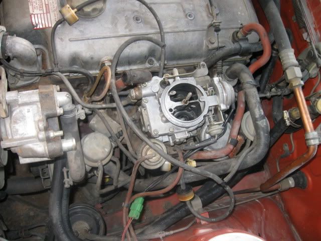

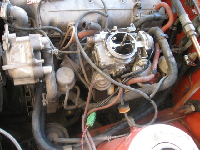

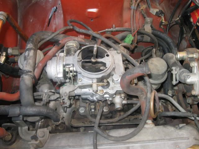

    this is what i am up against
    has anyone got a stock 18rc 7th month 1977 that they can take a couple of piccys for me
    thanks
    ian

    i got an 18R-C down at the farm, but that's a 76 pretty sure, and also pretty sure all polution gear blocked off / disconnected.
    Maybe do a bit of detective work with that pic and link i sent and a bit of trial and error?
