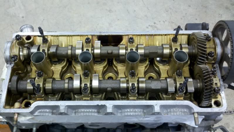

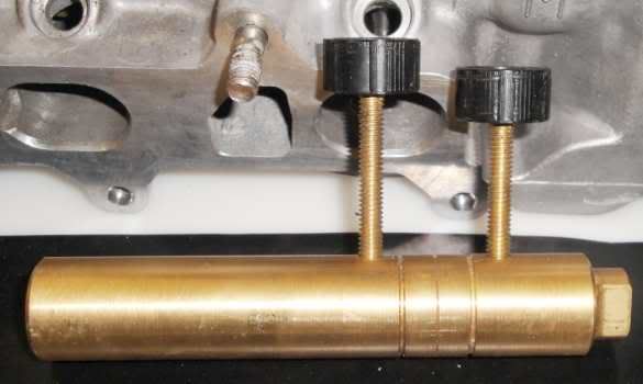

    It has been too long since my last update. I'm currently working on actuating the valves while on the flowbench. I had a friend make me an actuator for the G head, but alas, the G head and F head use different sized cam journals
    tool for 16V G head
    the problem is that tool will not fit in the "F" cam journal since the F journal is smaller.........
    Here is my first idea.... the toggle clamp is fastened to the neighboring journal - this should allow enough clearence for operation
    This one doesn't quite have enough reach to it, but I believe I can find* a toggle clamp to accomplish the job......
    * - by "find", i mean I'll look, but since this is a cheap crappy Harbor freight tool, I may just modify this one to work as I need it - by taking 2 of these clamps, and extending the arm part of the clamp by about 1 inch, and then moving the entire clamp to be better situated over the neighboring journal

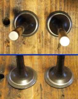

    well, I finally was able to get my friends lathe up and running.... so I was finally able to back cut the 4AF valves.....
    One things for sure... 4AF valves are utter crap... look (below) at how irregular the exhaust valves can be.... The valve on the right fits the seat and now has a back cut, but you can see the valve on the right is NOT uniform in shape by evidence of the irregular shaped back cut

    irregular back cut on that right valve.
    Was it in a 4 jaw or 3 jaw chuck? (4 jaw gives more control over centering)
    Nice set of grinding wheels you've got hanging up in the background there OldSkewl
    ..when faced with an irregular or out of round shape in a lathe, I remove material with a very fine file resting against the job as it spins.
    That way the file just follows the contour of the job & removes material in an even fashion.
    It takes a steady hand, a lot like die grinding & porting. I use a fine file, so if I slip it does minimal damage. More importantly a fine file removes material in a safe & gradual manner.
    (haven't ported yet but I've done years of lathe, die grinding & hand engraving work)

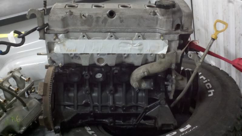

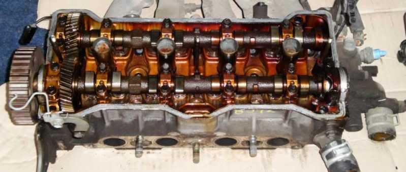

    I've been told that the later engine has much more lift to the cams.... the head is better since Toyota moved the intake ports up about 15mm(+ or -) so that the port would have a gradual slant down to the valve.
    here is that later type head... you can see the ports are a bit higher up on the side(behind the tape)...
    here is a newer type "F" head... can you note the changes????
    here is my "F" head

    There are a few obvious changes between the early and later types - cam cover mounts to cradle stud, instead of center stud... the location of the intake port @ the manifold flange has been rasied. The other BIG change... the ability to run big cams... or should I say bigger than the 6.7mm lift my 4AF is running. Look @ the bucket supports, note how tall they are on my head, compare then with the much lower casting of the newer F head.
    The last generation F head can't really be compared to the 1st gen, or if you must, think of it in relation of a 20V compared to an early TVIS head... both bolt on to the block... but the similarity ends there.

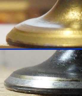

    making her all she can be back cut intake valves

    how steep did you cut, looks almost 30 degrees?
    nice macro
