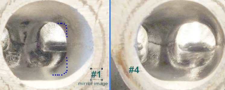

I ask for your assistance.... since I currently do NOT have any spare "F" heads, I need to "practice" somewhere.
And since toymods.org is the brightest Toyota Think Tank I know of....
here is my 1st idea for porting the crappy port.
at least with the above, there is very minimal chance of breaking through to either oil, or water galley. I chose NOT to remove more material from the thinnest part of the wall, but to remove the large arc, for far more port wall, and a much smaller arc - 2 arcs actually, the port floor and roof......
Like it? Hate it? Why?
edit... this head will get flow bench time to attempt to equalize exhaust flow

it is an interesting excercise and I have to be the downer but with the OEM ECU choking it with the sedate ignition timing would there be any real change at all with any amount of porting?
not denying the likely mild ignition timing... but do you know the timiing #s?
Let me go back to the beginning.... the 1st generation engine has a CRAPPY torque curve..... the 2nd generation uses the same, or very similar head, a shorter narrower manifold and more torque, eariler. (see pdf link I posted) What I'm after right now is to just allow smooth efficient operation.... to maximize what is there.....
I NEED to replace the engine in my daily... it has a rod knock. the replacement block is a 20V unit(machined to accept the all-trac drivetrain) the internals will be 4AGE bits - using 4AGZE slugs under the "F" head gives me a CR of 10 to 1, or a 1/2 point higher than stock. Sooo... what I'm trying to do here is get a strong replacement bottom end in. Since I have a new bottom end, I thought I'd just do some cleanup porting to improve what is there.... so back to my original request... knowing things could be better... what should I do to make this as good as I can.......
I don't know the timing numbers.
Now don't get me wrong I like what your doing and I am finding this thread really interesting. I just didn't want you have less results than what you could have. I do understand why your doing it and I would probably do the same in your situation.
