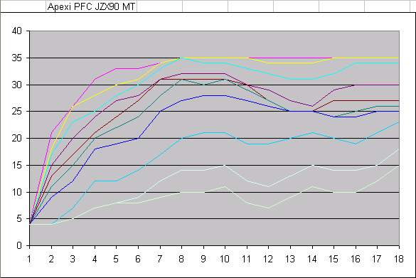

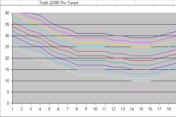

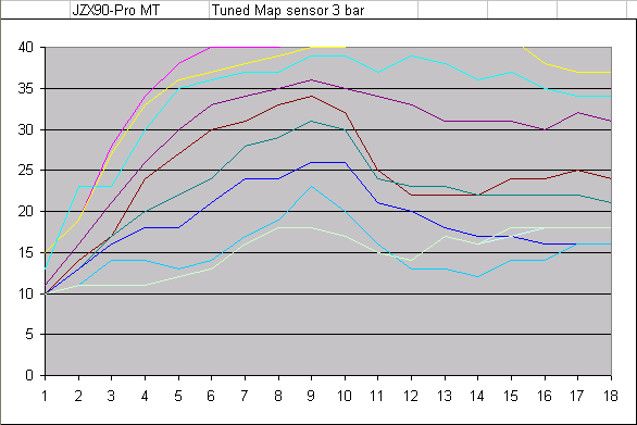

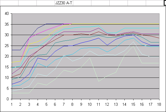

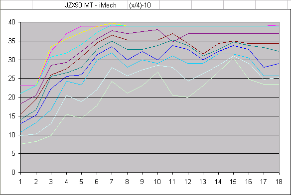

    I have re-created a set of ignition graphs comparing various tunes for the 1JZ-GTE.
    Most would be genuinely interested in the stock ignition curve, since it clearly shows how it has been truly de-tuned. Keep in mind max load would be lower than any of the other graphs.
    Each graph cannot be directly compared since each line represents a different load, even for the PowerFCs. Eventually I would like to obtain consistent load-per-line, especially for max load.
    horizontal scale is RPM*400, vertical scale is IGN BTDC.
    JZZ30 AT: stock
    JZX90 MT: chipped
