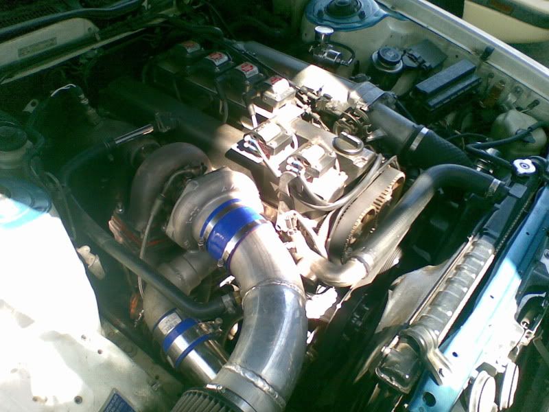

    Default Re: 1JZ big (ish) single on stock ecu?
    garret do a 500hp (roughfly) bush bearing turbo looks similar to a gt30/35 i have sold about 6 of them your looking at about $900 brand new (and yes they are garrett not chinese come direct from garrett australia) come with 360 degree thrust bearings and a choice of .63 .82 1.0 exhaust housings, we put one o a 1jz with standard computer and works beautifly. also used one on a 3rz and made 350rwhp on 14psi. will see if i can find the rest of the specs if your interested
    123
    thats the one we put on the 1jz with standard computer i think it made about 300rwhp on 15psi, i just checked price to and can do one for $875 think they retail for $1050 garret made them to compete with the likes of the kkr480

    Quote Originally Posted by sleepercorty View Post
    PIC
    Sounds decent enough to me, oddly enough the kkr480 was something i was considering, do you have the model number or anything?
