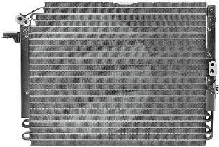

    most of the 90's toyo stuff still used serpintine condensors. Parrallel flow have two "tanks" and mulitple tubes that run from either tank. Im thinking, and without actually seeing what you have would of thought use would be a serpentine condensor. They are esentially one long tube.

    Quote Originally Posted by matty12 View Post
    You sure dude?
    More of the 80's stuff I've played with has been parallel.

    Feb 2009
    195
    Default Re: A/C Condenser fan placement, draw or blow through?
    my ls400 is, 80 series cruiser is, hilux Ln106, corolla up to ae112, wide body camry sxv20 etc.
    They went from those to sub cool parrallel flow condensors for most models.
    100 series crusier. yaris, Prado, zze122 corolla, vzn/rzn hilux etc.
    Like i said im sure the expensive "a/c flush" is just shellite.

    matty12, are serpentine flow condensers more efficient than parallel, I'm taking it as the gas has a longer route to take it will keep getting cooled more, or does it not make a difference?

    nah the parrallel are more efficient, far closer tube pitch and greater fins per inch to start with.Its quite possible that yours is a parrallel condensor i just havent seen any or really worked on any 80's stuff. Got any pics??
    I remember reading some wher though that thers is a pressure drop difference between the two, cant remember exact details and what the results were, will check on monday.You have to remember too that r12 didnt need it too be that effecient compared to R134a and a/c in a vehicle was a treat back then where as everone expect a/c these days to be 100%.
