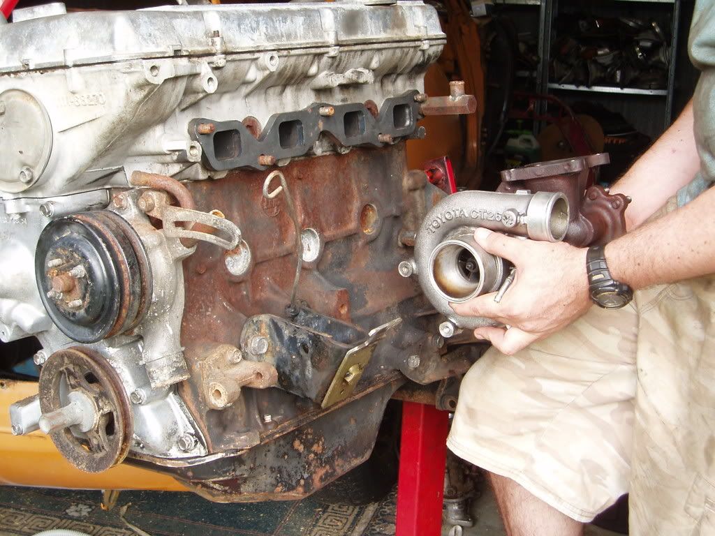

    Well, this is the approximate postion the turbo will be on

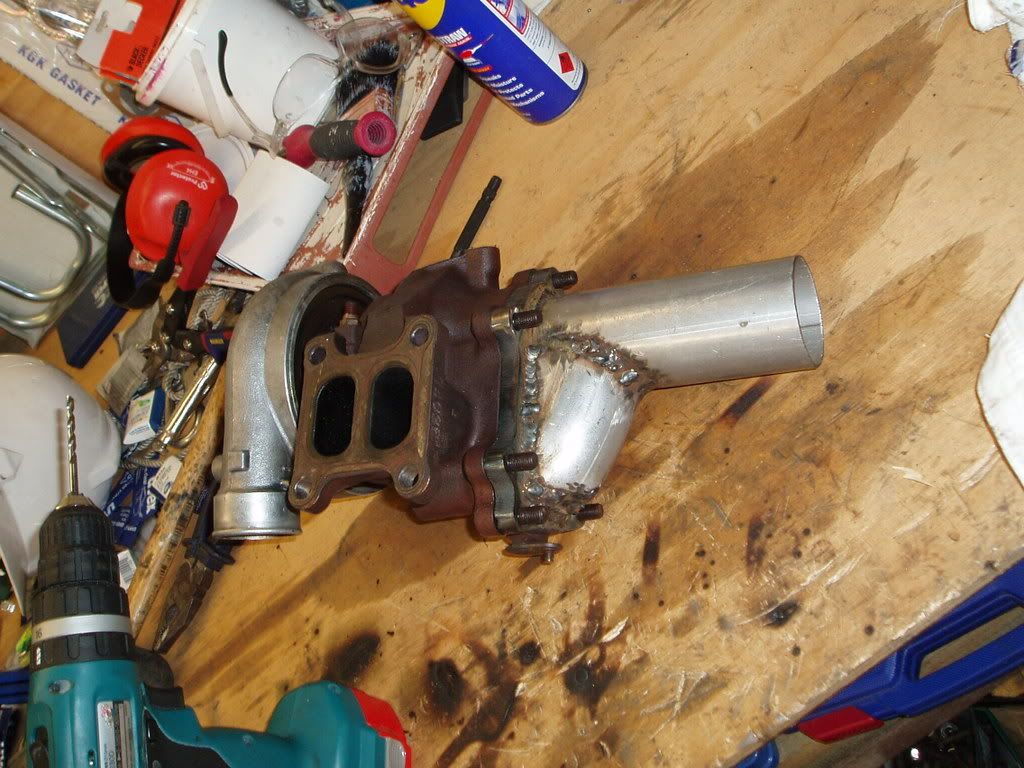

    And this is the first section of my dump pipe
    and from inside

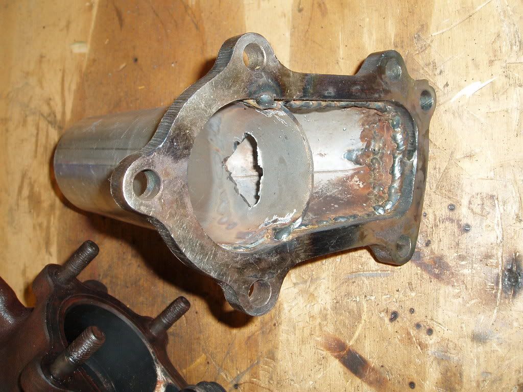

    Note the separate chambers for the wastegate and main outlet to help spool it. Oh, and the fully Ghetto spec wastegate chamber hole... it should work (hopefully)

    Bad bad bad mate....all that will do is give you horrid overboost spikes.
    If you want improved spool, you achieve that by controlling the WG actuator.....m,many ways i can run you thru?
    For the actual DP, get the WG flow path as large and as neat as you can to get the best boost control.
    I don't mean to sound harsh but what you have there is really really crap

    Haha, yeah I knew it wasnt great, but im not after large boost or anything so didnt think it mattered all that much. I have 2 options, improve the hole that goes to the main pipe, or cut the barricade out completely and leave it an open void like OEM. Improving the hole will be more work (and I will probably need a new diegrinding burr), but will it be any of an improvement over having just a void?? Thanks for any advice, I am still learning turbo systems. For the 3S, I will just buy a ready made stainless dump.

    Best option with what you have is to take out the separating plate completely. If you have the room i would try and merge the WG side more gradually into the main pipe as well.
    I ran a similar style DP on my white GT4 at one point and gave a stable 19psi from the CT20B.
    less boost = more wastegate flow = more restriction from tiny hole = more boost creep/spikes.
