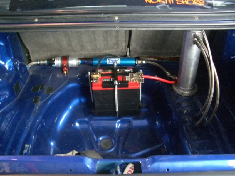

    I use the big long style mesh filters for high flow applications.
    They are around 250mm long 40mm-50mm in diameter. I can get them for $140NZD .
