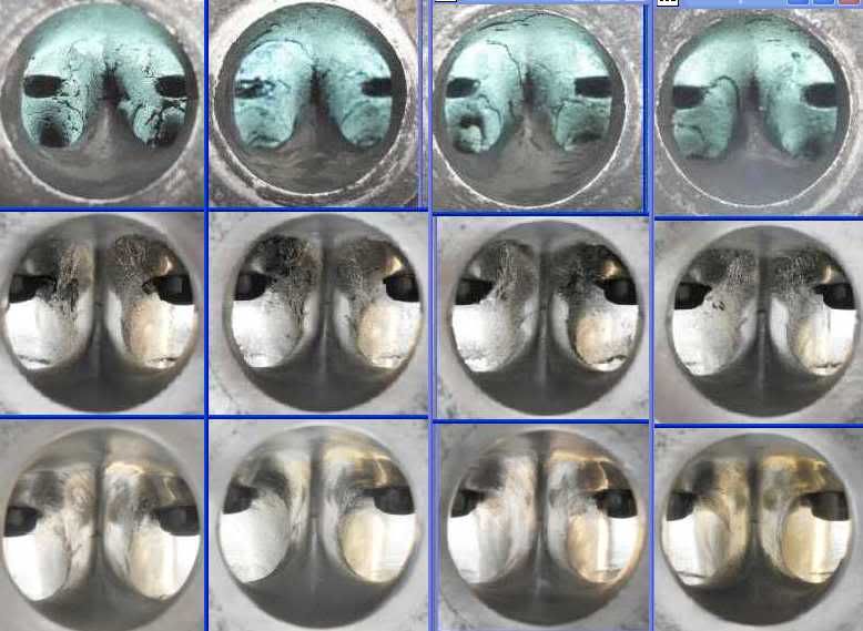

    The port above was my very first attempt @ reconfiguring the splitter.
    Below is my 2nd attempt. This one was just nasty.... note the pre splitter reconfiguration, the un-even shape of the splitter.
    What is "special" about this port is this very port I had put on the flowbench last year to check how much my bowl work improved flow over a pre bowl work. Here are those numbers
    Now I just have to get the head back to the flowbench for testing

    I'm not impressed - looking @ the roof of his exhaust port it does not look condusive to optimal flow. The bowls look fair enough, but the roof of the port appears to be less blended - pinching the flow down.
    port on Left Loyning's, port on right TK's
    Here is a very interesting thread measuring(flowbench) blacktop, largeport, and smallport heads..... http://forums.club4ag.com/zerothread?id=80960

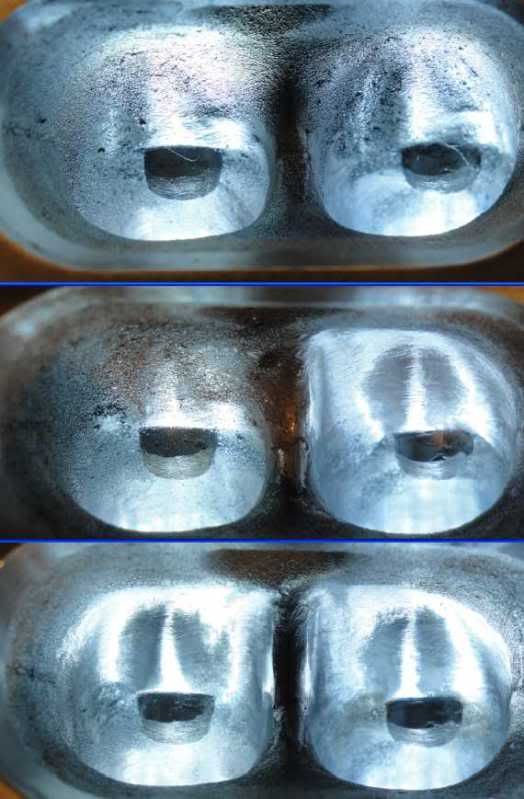

    Here is some recent exhaust port work performed by me on a smallport head...
    #1 on the left, #4 on the right

    The intake was the only change, so only new intake #s are supplied, the new flow #s are........ these are measured @ 25"
    .050 - 39.1cc
    .100 - 75.3
    .150 - 114.9
    .200 - 152.7
    .250 - 171.2
    .300 - 181.3
    .350 - 186.0
    .400 - 189.6
    .450 - 191.4
    I'm not impressed with the absense of change... what is there is incremental @ best
