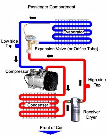

    for educationary purposes, this is a basic A/C layout.
    a reputable radiator/aircon place can install an after-market setup for you
    or you can rip an old system out and use that (if its ok)
    the main problem with an old system is leaks and internal corrosion
    replacing the compressor will be a must because the R12 gas is no longer available/used

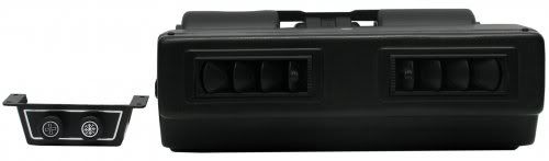

    under dash unit
    this is an easier way to retrofit A/C to the old school cars
    no need for tubing and searching for original indash unit/controlls cabling and the like.
    all that said, would probably look ghey in more modern cars
    the evaporator and fan is encased in this unit...

    The knee freeze pictured above is another soluiton but look sh1thouse and then require someone to fit and make lines.
