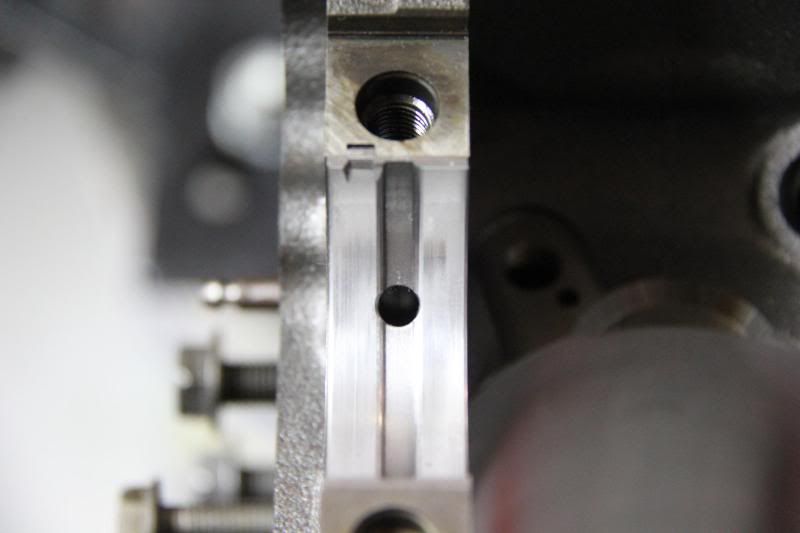

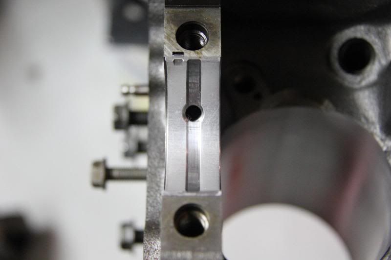

    The TRD ones will have chamfered oil grooves like the Toga bearings and ACL race bearings.
    Toga
    Toyota OEM
