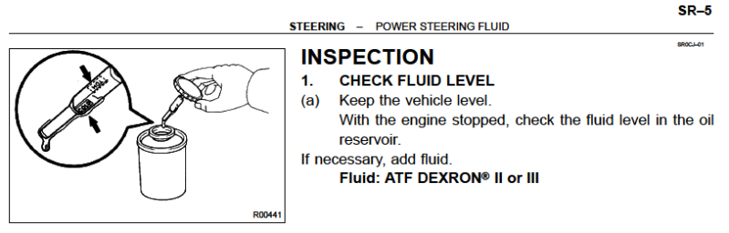

    "Z" Ute, TSRM says DexII or DexIII
    http://www.turbosupras.com/pages/en/...al/a80tsrm.htm

    +1 for Dex 3 ATF in both PS and Hydrofan.
    Z Ute - Your pump is probably on the way out, using the thicker PS fluid has only masked the problem?
