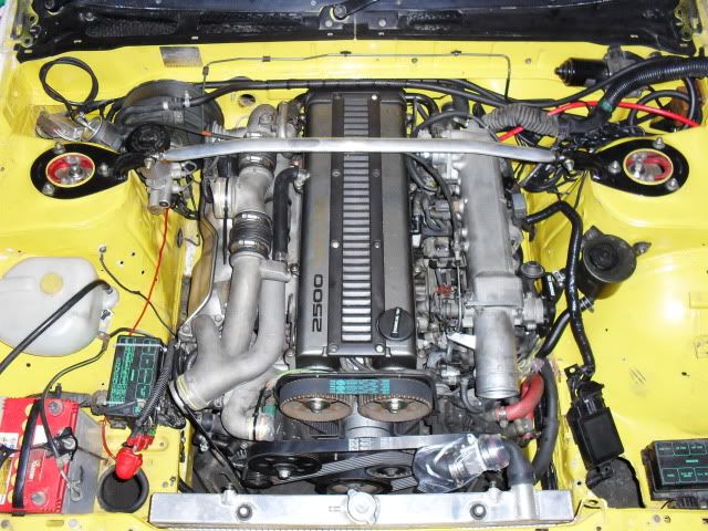

    The above is my brothers car (picture is a little old). It is a 1JZ in a 180SX, and there are no issues with bonnet clearance. Both factory looms have been integrated, and the factory tacho and speedo work via Dakota Digital Boxes. Both of the Blitz ECUs on the other hand The factory Toyota ECU works faultlessly. The ISCV has been the only real source of grief.
    The car used a US made fitting kit, and we have retained the R154. The gearbox is a very tight fit, but required no modifications to the the gearbox tunnel or firewall. The engine crossmember was untouched. You'll find that the clutch master cylinder will have clearance issues. My brother used an S14 one if memory serves me correctly. The turbo side is VERY tight, I'd look at swapping in a single if you have the cash. The radiator will allow the fitment of fans behind it, but it will be tight. I don't know how much further things stick out at the front of a 2JZ, but there is *just* enough room on the 1JZ. This is with an aftermarket 50mm radiator and just a single thermo fan with the radiator support un-cut.
    The extra weight of the 1JZ has lowered the car by ~10mm at the front. That is with Apexi N1 Type V coilovers with an 8KG spring. It has a Whiteline swaybar, and that needed to be spaced down 15mm as it basically rested against the sump.
    The car is complete, and will be dropped onto a dyno either Sunday or next week. It'll be running on the 11th at the drift comp at Baskerville Raceway Just look for a white 180SX with a widebody kit with 17x9 and 19x9.5 Rota RBs
