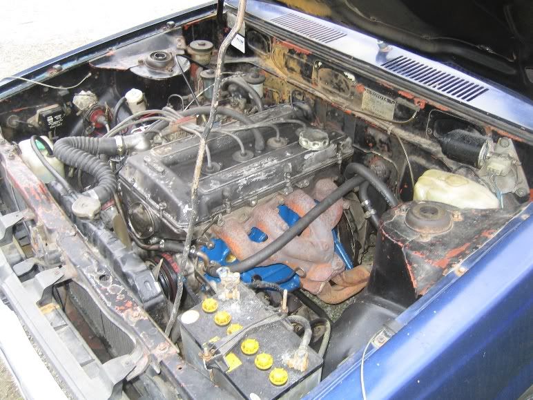

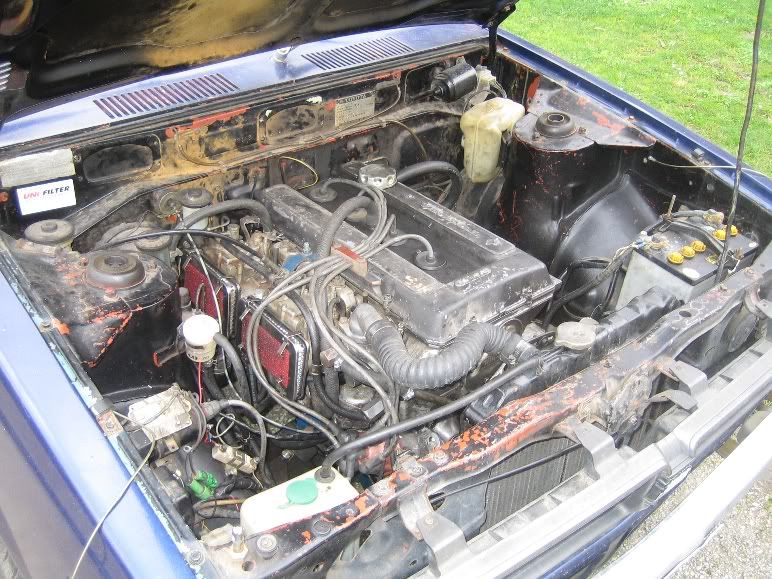

I've put an 18RG in a KE35 before. Just had to fab up engine mounts and gearbox cross member, and convert clutch pedal. It went well but if your racing I have to agree with the others, a 4AGE would give you a better balanced car, and its a fair bit smaller, but thats something for you to decide.
It doesn't look overly pretty. There wasn't much space for the aircleaners between the carbs and the brake booster. I got the engine cheap enough and it was a bit of fun.
http://i899.photobucket.com/albums/a...RG2resized.jpg
http://i899.photobucket.com/albums/a...8RGresized.jpg
