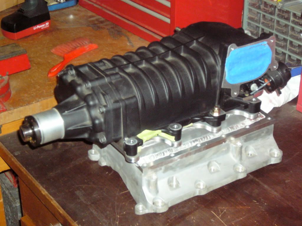

    Default Re: Twin SC14s on a 1UZ?
    This is the sort of thing you need Ed
    Should be running next week....fark better be
    1,917
    Hey mate, can I ask what is the height of these babies at the front and also rear?
    1996 FZJ80 Landcruiser.
    Email : [email protected]
    4,626
    Quote Originally Posted by TurboRA28 View Post
    If you could tell....how much higher is it compared to the stock inlet manifold.
