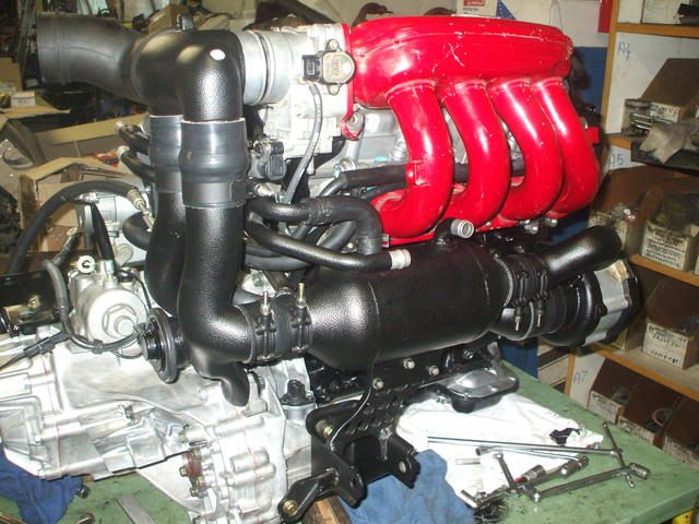

    thought this may be of interest to you. not a PD charger but it's a SC'd 3s
    part 1
    http://www.mr2oc.com/showthread.php?t=323444
    part2
    http://www.mr2oc.com/showthread.php?t=354271
    part 3
    http://www.mr2oc.com/showthread.php?t=376401

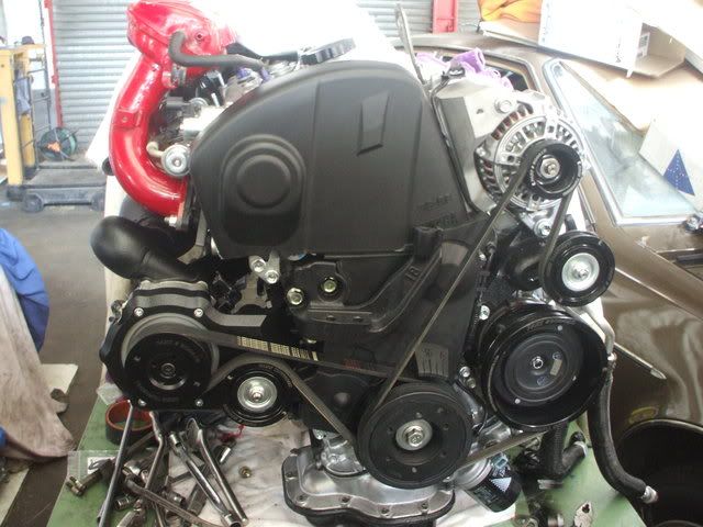

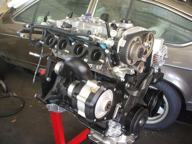

    become one then....basically a dude(he's in aus actually) has put a redtop beams in his sw20 with a rotrex supercharger, and done his own cutom billet and other custom fabricated parts.
    it's the neatest fitment you'll ever find. dunno if he's just a perfectionist or is slightly obsessive compulsive but the work he's one is faultless.
    i'll seee if i can drag some images across.

    Bloody hell there's some dollars in that! Laid up his own CF intake piping? serious shit
    wa
    1,174
    Default Re: 5SGTE, what block to use?
    these are just a couple of pics more for engine, but his thread's are full of little ally bracket's/pulley's etc he's fab'd or had fab'd.
    the time, care and attn he's put into it would've resulted in a divorce surely.....if he was married.
    i think he made the IC pipes from cast ally(made it all, the mould's plugs etc himself)
    that CF is the underbody guard........not where i'd chose to put anf CF if i had some.
