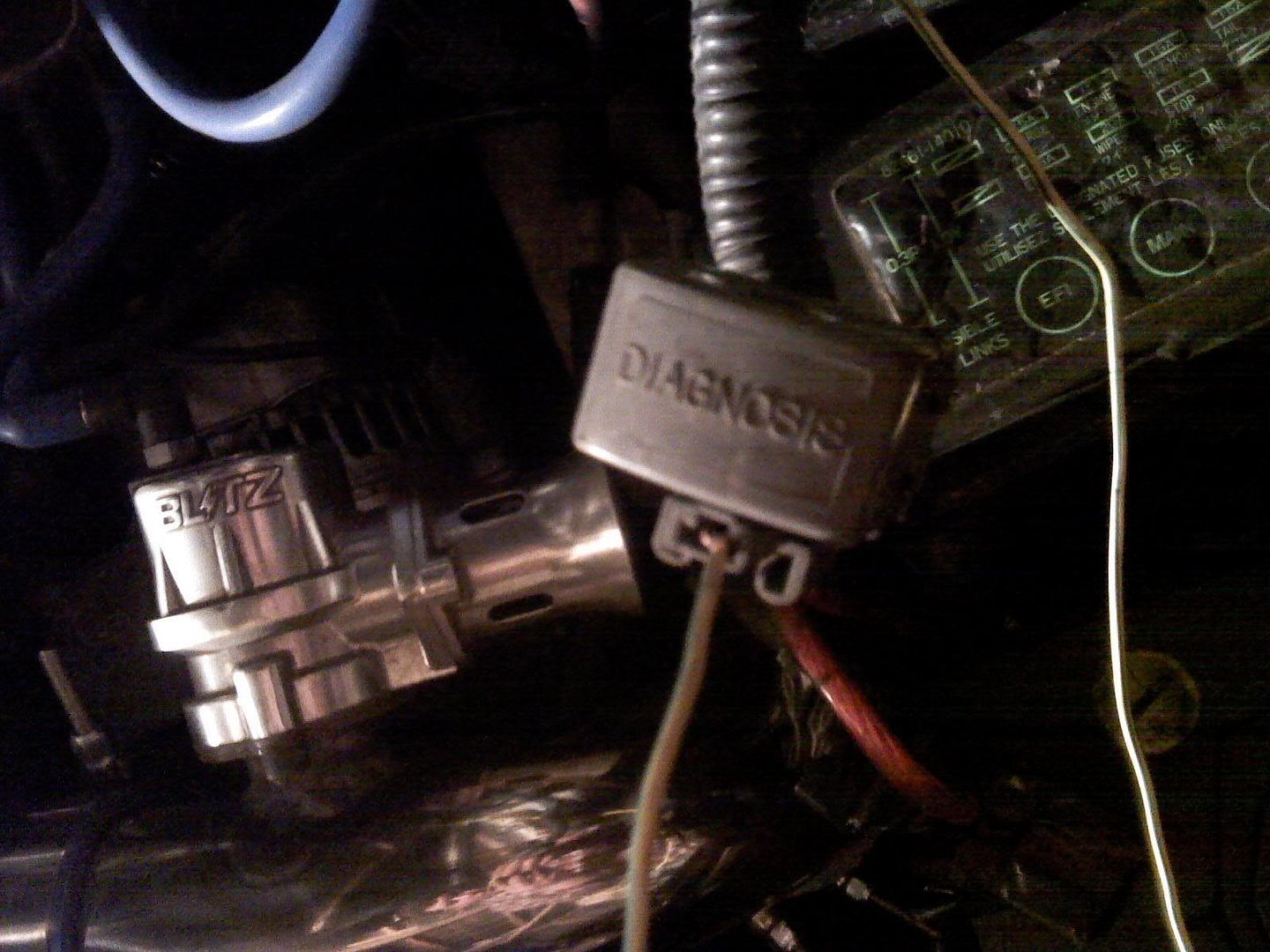

    Just wanting to know where the easiest place to wire in the booster would be, I think both wires i need to connect to are located in the drivers side kick panel, but i am unsure what ones they are. From my 1GGTE engine
    Also for the booster is any relay ok to use or does it have to be the speficic one from the guide?
    car is a GA61 Celica Supra with a 1GGTE Original engine was the mighty 1GEU
    8,214
    Default Re: GA61 tacho wires (wiring in tacho booster)
    Any relay is fine.
    Use the IG- wire from the Diagnostics box.
    Trace that back to the main 30pin plug behind the glovebox.

    Is there just one wire coming from the diagnostics box?
    also What wire coming from my dash is the correct one?

    There are plenty of wires coming back from the diagnostics box, but only one is the tacho wire (IG-)
    As for finding the original wire, find the original loom, and trace the negative side of the coil back to the plugs behind the glovebox. This wire will connect to the tacho.
    They are normally plain black wires.

    Excuse my ignorance but Are there any diagrams showing what wires come from the diagnostics box?
    8,214
    There is a sticker in the inside of the lid

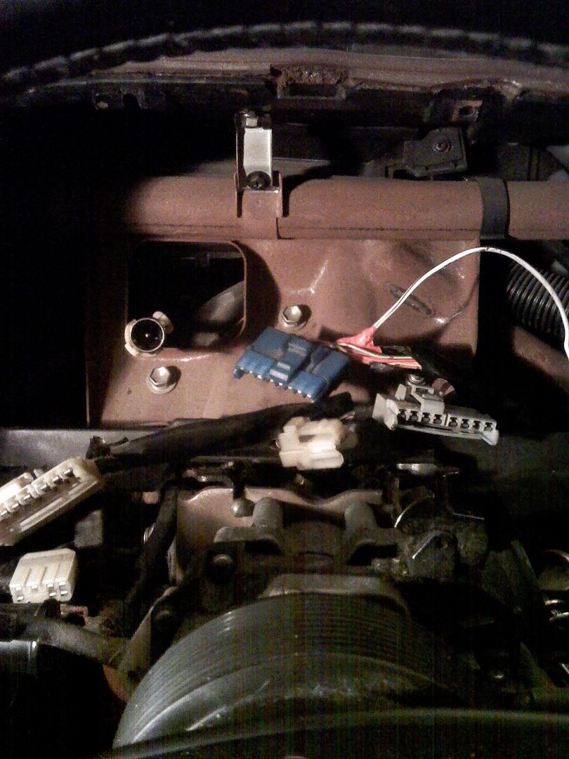

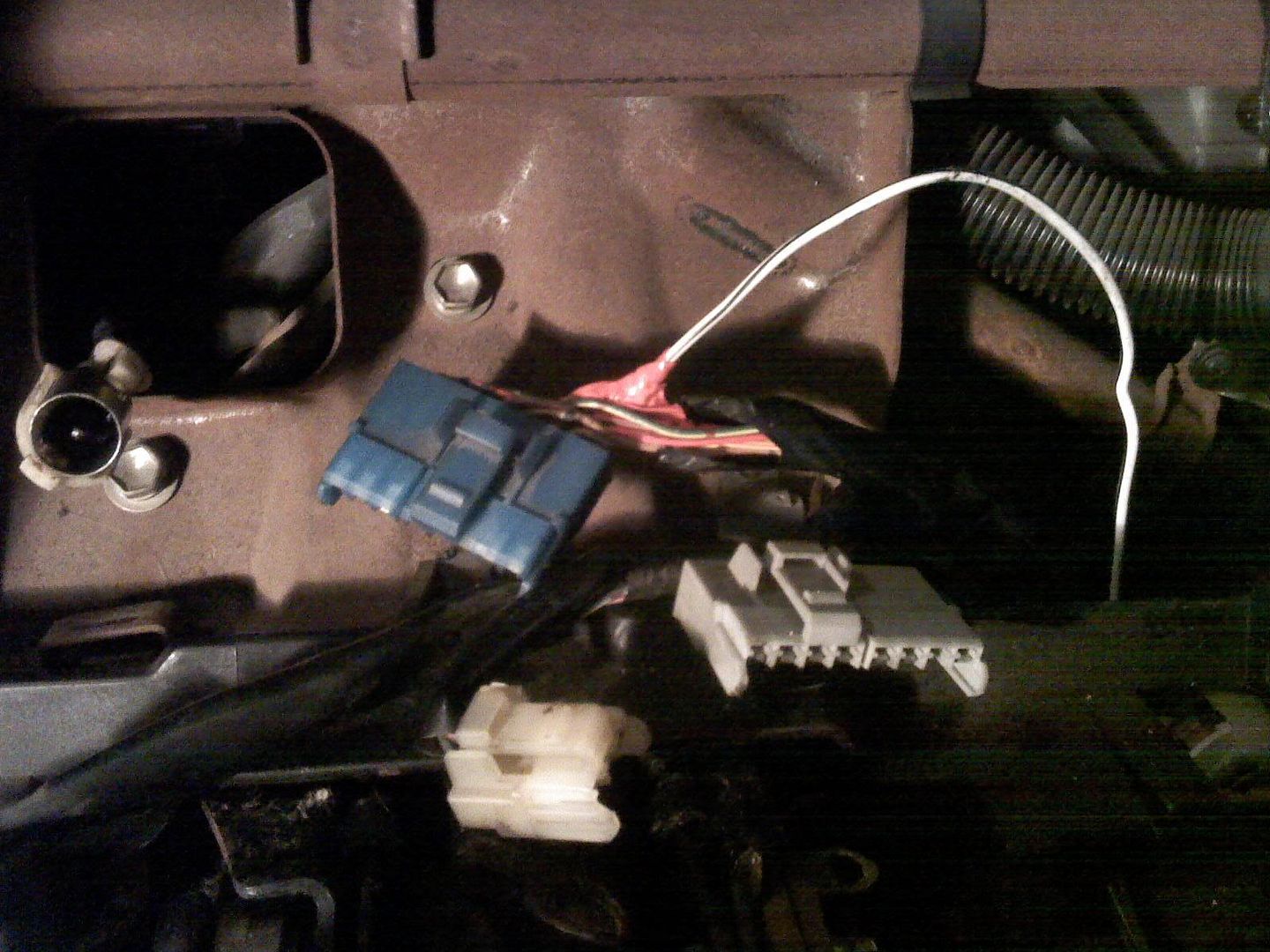

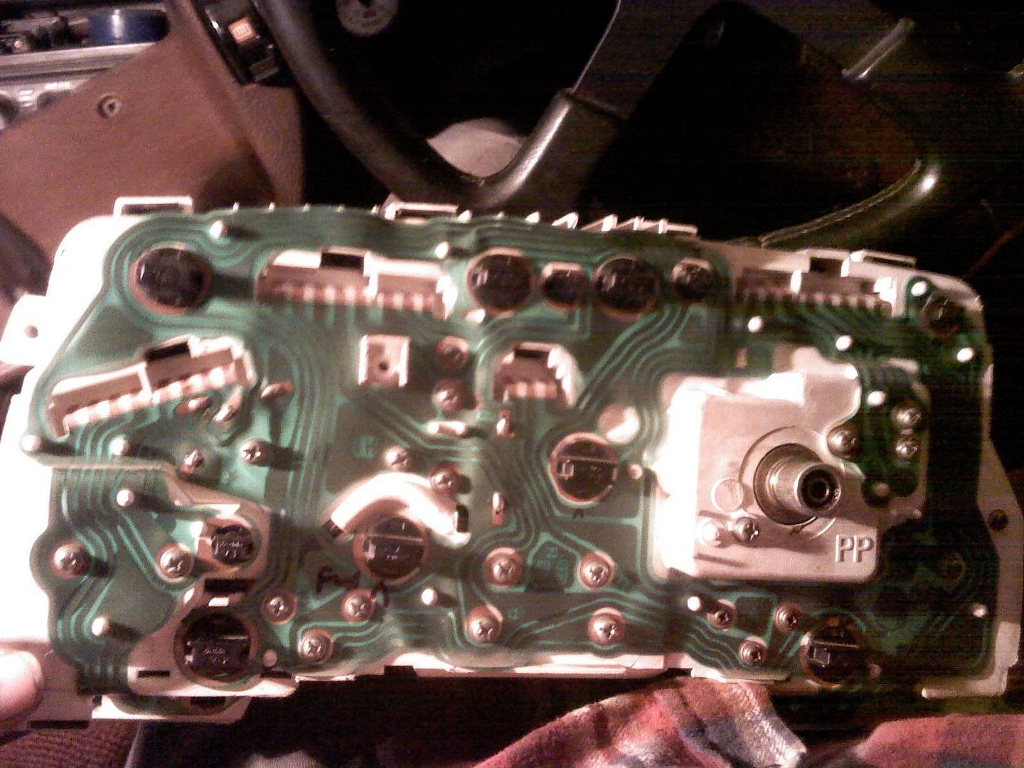

    Right was doing this today.
    I ran a wire from the IG- on the dianostics box, to the black wire on one of the plugs guage clustor, that was solid black. Didnt send any signal, And i haven't wired in the taco booster, It should still show some revs tho?
    anyway
    Apr 2010
    nz
    53
    Im not sure what wire in the dash i should connect it into...what am i doing wrong
