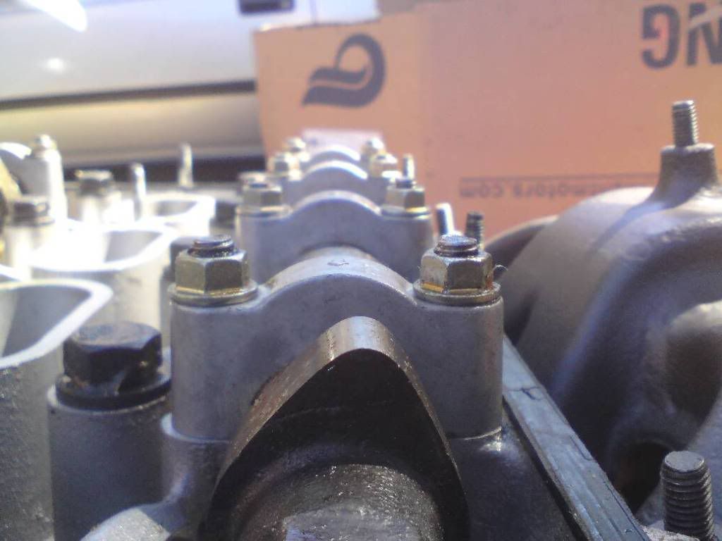

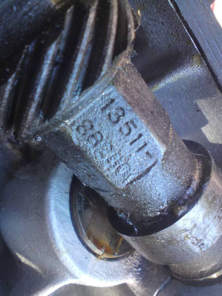

    Hey guys,
    I've recently purchased a 3T-GTE and the source that it came from said the cam's were 'bigger' than standard. Now they didn't come with a cam card, though they do have numbers stamped on them
    13511-88280 is the number
    And here are some pics of the profile:
    So does anyone know if they are re-grounds, after-market or standard??
    Thanks,
    Al

    Default Re: 3T-GTE Cam identification HELP!
    The number on the cam is the standard factory part number. Unable to tell wether uprated without duration and lift measurements.
    looks like stock cams. Can't see any weld and grind marks or under size lobe grind marks.
    Al,
    Get your hands on a Dial indicator and check the lift on the cams. Its pretty easy to do.
    Let us know what lift they measure in mm (ie 9.2mm etc)
