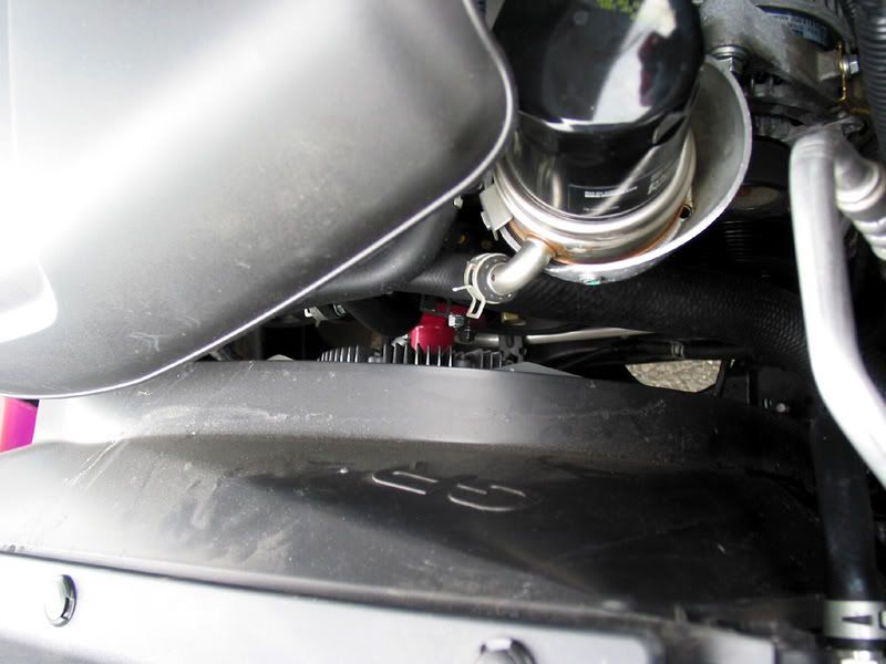

    I am looking for options for a water-cooled oil cooler for a 4age (blacktop). It's in a mk1 mr2, so not much airflow, and I have heaps of surplus water cooling capacity.
    I don't want to use the stock mr2 oil-water cooler, so I'm looking for alternatives.
    It's not a race car, so the cooler doesn't need a lot of capacity.
    Can the Camry cooler (under the oil filter) be fitted to a 4age ?
    Does anyone have measurements of one ? or pictures ?
    Is it any use ?
    Any other suggestions ? I read good things about laminova coolers, but they're way expensive.

    Sep 2009
    327
    Default Re: oil -> water cooler
    Toyota engines with oil->water coolers :
    mk1 mr2 (aw11) : 4age
    Bypass type - oil is tapped from the oil filter, flows through cooler, drains to sump.
    Oil flow through cooler is controlled by a spring/piston pressure valve. I assume the pressure at the cooler bypass must be lower than the oil pump relief spring, and the cooler and oil lines are low pressure.
    Camry ('94 5SFE ?)
    Full-low sandwich type, with pressure bypass.
    http://www.tundrasolutions.com/forum...k-oilcoole.pdf
    Camry dimensions (from the web)
    filter flange ID 2-1/2", filter flange OD 2-3/4", suits oil filter with a 3/4 in. -16 thread and 2-5/8 in. diameter O-ring.
    Celica (1zz) - some markets
    Full-low sandwich type.
    TRD cooler :
    Tacoma (US) - towing pack - what is this called in Aus, if it came here ?
    Non-Toyota :
    VW Golf (r32)
    WRX 02-07
    Jeep patriot (US)
    I'll measure the 4a filter housing tonight; if anyone has links to what filter sizes fit what toyota engines, post them up.
    Ideally I would like a bolt-on solution; the water plumbing should not be a problem.
    edit
    4age filter o-ring appears to be 2 1/2"
    celica is 2 1/2" up to '93, then 2 5/8".

    adrianS.. that second picture you posted is a HILUX, with a turbo diesel motor, brand new model...
    and btw, its a heat exchanger.. its not for cooling performance its for keeping the temperatures around the same temp....
    if you want cooling performance, purchase independant coolers..
