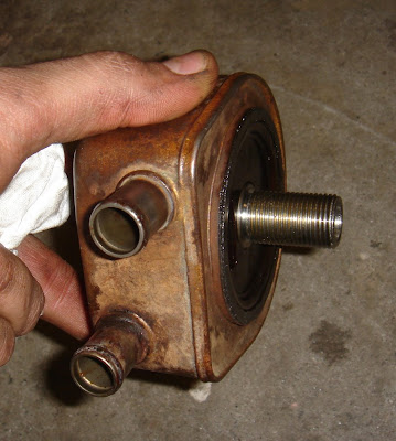

    As the 88kw aw11 mr2 had a factory oil cooler, and I'm fitting a 120kw blacktop in, I want to play safe and fit an oil cooler of some sort. With the engine in the back, cool air is limited, so I'm checking out / asking about options for water cooling.
    Having decided not to use the factory setup as explained above, tonight I removed all the cooling hoses and heat exchangers from the engine bay. The engine will go in without a cooler for now, because I want it back on the road ASAP, but I will def. be fitting something, probably a sandwich plate with thermostat and external water cooler.

    the v6 benz motors have a huge exchanger (20cm * 10 * 10 roughly)bolted to the side of the oil filter housing - I dont think it could be utilised in this case though as they use a filter cartridge.

    thats what the MB ones are like. seem to do the job quite well. And all the big 8s have an external cooler as well

    A thermostat is less necessary, as the oil can never get colder than the coolant (~85 C). If your water takeoff is somehere after the thermostat, there will be no cooling until the water is up to temp.
    The mr2 and laminova (and some US Ford?) coolers are designed to sit in the main radiator coolant flow; most of the others are plumbed into a bypass of some sort.
