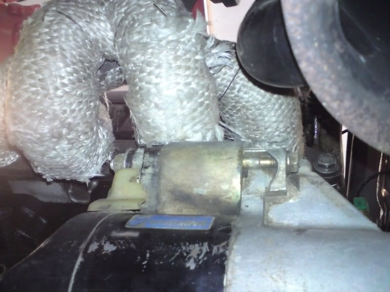

    Hello all, just put my turbo manifold on and noticed that it is sitting directly on the starter solarnoid. I am using a 230mm flywheel and a bigport starter. My question is can i use a Corona or Celica 225mm flywheel starter and do either starters solarnoids face down towards the sump. Any help would be appreciated.

    What manifold is it can you post pics?
    Its quite likely it will be able to be modified, but if its a cast iron manifold anything but not touching it will weaken it.

    Cheers Casey and Talasas for the replys, took some photos today so you may get a better idea. The manifold is i think a Azcustoms high mount.
