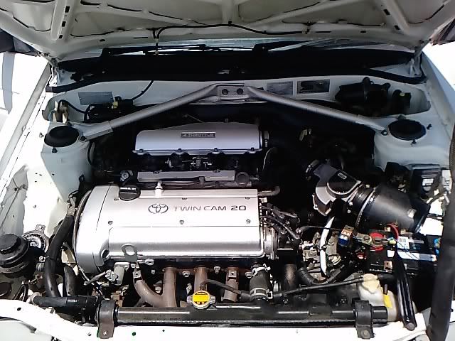

    ok lets go back to the start, what's the engine in? tell us what it has now and show pics if possible

    AE82
    4AGE
    7700 MAX
    On the track it feels like it should have more in it before it hits limiter and id like to pull another 500rpm if possible
