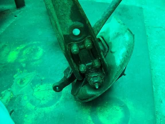

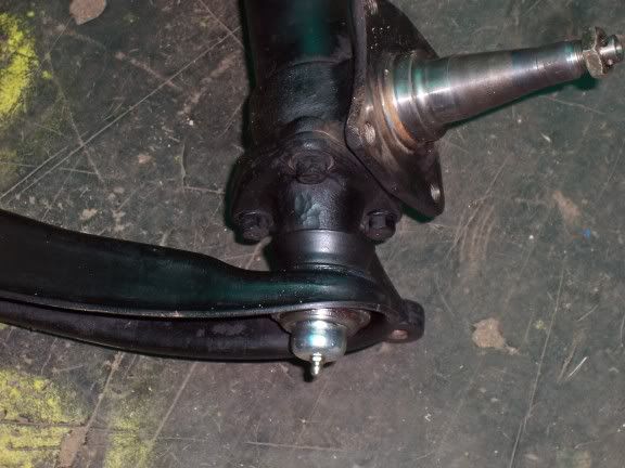

    Im pretty sure the GE and GH are 3 bolt and I think all models after were 2. Its been a while though so I may be wrong.
    GH Scorpion
    http://i21.photobucket.com/albums/b2...t/100_0995.jpg
    GJ Scorpion
    http://i21.photobucket.com/albums/b2...t/100_0996.jpg
