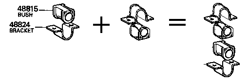

When I did this I used stock Toyota swaybar brackets that have a bolt hole for each end, get new swaybar bushes to suit, and bolt them together...
i.e.
