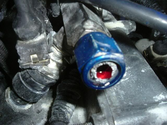

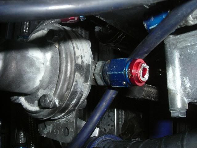

    Eeep, is that solid mounted to the block? With that amount of weight on it i have seen Speedflow fittings fail quite spectacularly and nastily.
    The worst one that i have seen photos of is on a guys Cosworth as seen here:
    I would highly reccomend either bracing it or mounting it on a flexible line.

    That pic looks like the the pressure reg is mounted off of the motor and rail is obviously attached to the motor. so when the motor kicks the rail will move and the reg wont.
    I think thats what has caused that !
    But i do see what you guys are talking about !
    5,543
    Default Re: Oil Cooling a 4agze
    The rail is attached to the motor, but the reg wasnt mounted to anything. Hence there was a large longditudinal load off the axis of the mounting point (i.e. the fuel rail). Same with yours, only the mounting point is the boss in the block.
    That one ended up in a $4k engine fire.
