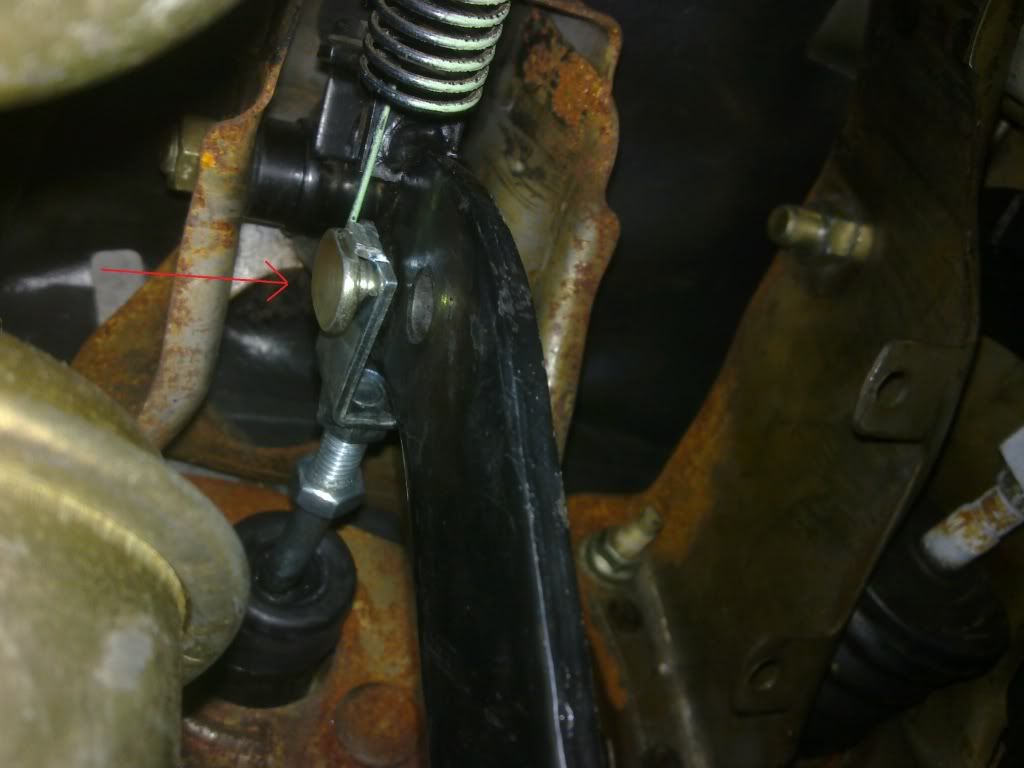

    And problem solved.
    thankyou all for all your help that gave me the will and courage to actually take a look at it .
    funny enough, that the problem was so basic , no one could have thorught of it....
    check out this pic
    i had the gold pin that the safety pin + pull back spring connect to.. through the LOWER hole on the pedal arm, and simply moving it to the upper hole fixed absoloutely everything.
    once again thanks all that posted.
    hope this might help someone out in the future....
